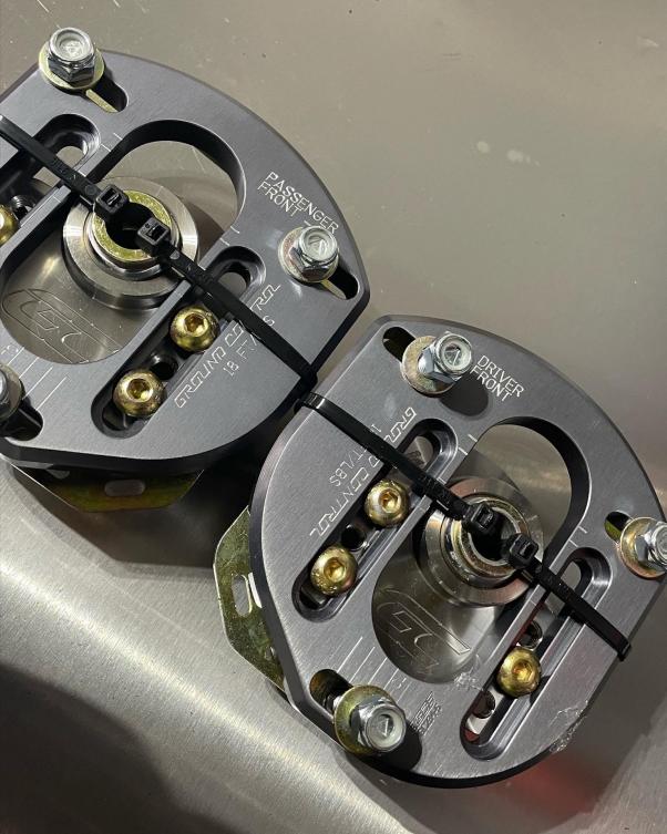

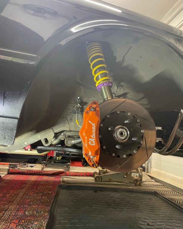

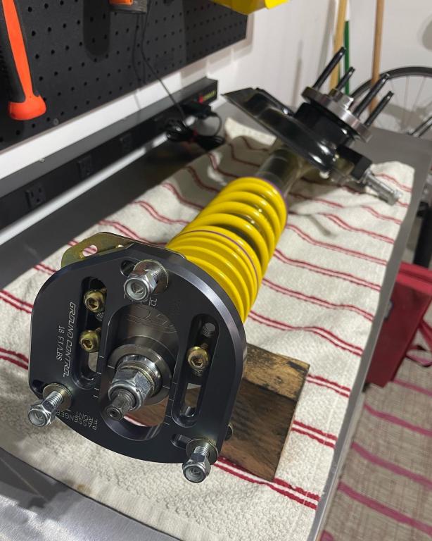

    Finally finished putting the black car back together. I did a myriad of stuff to it but the main focus was the suspension. I have been running my original Tokico setup since 2002 and it was totally time for an upgrade. I bought that setup on sale from a NOPI for 300 bucks. It lasted forever and when i took everything off, all the parts were still in really good shape for their age.
    That being said, this setup is a complete upgrade in all ways possible. its pricey, but it is the best quality i have ever seen and i am very pleased with it. the GC adjustable mounts are probably overkill but screw it, if I'm spending the money on the suspension i may as well go all out. pics installed were before an alignment and adjustments. I am still running the bumps and dampers on the suggested settings until i can get used to them but so far it is really solid. let me know your thoughts and if you have any questions.

        delatlanta1281 I've just had KW V3 installed and found that my TRM C1 15x8 +20 wheels just slightly touched the coilover. They were fine with the previous 51mm Bilstein/H&R combo. Now I'm running a 3mm spacer to ensure no rubbing the strut.
        Did you find this at all with your wheel setup?
