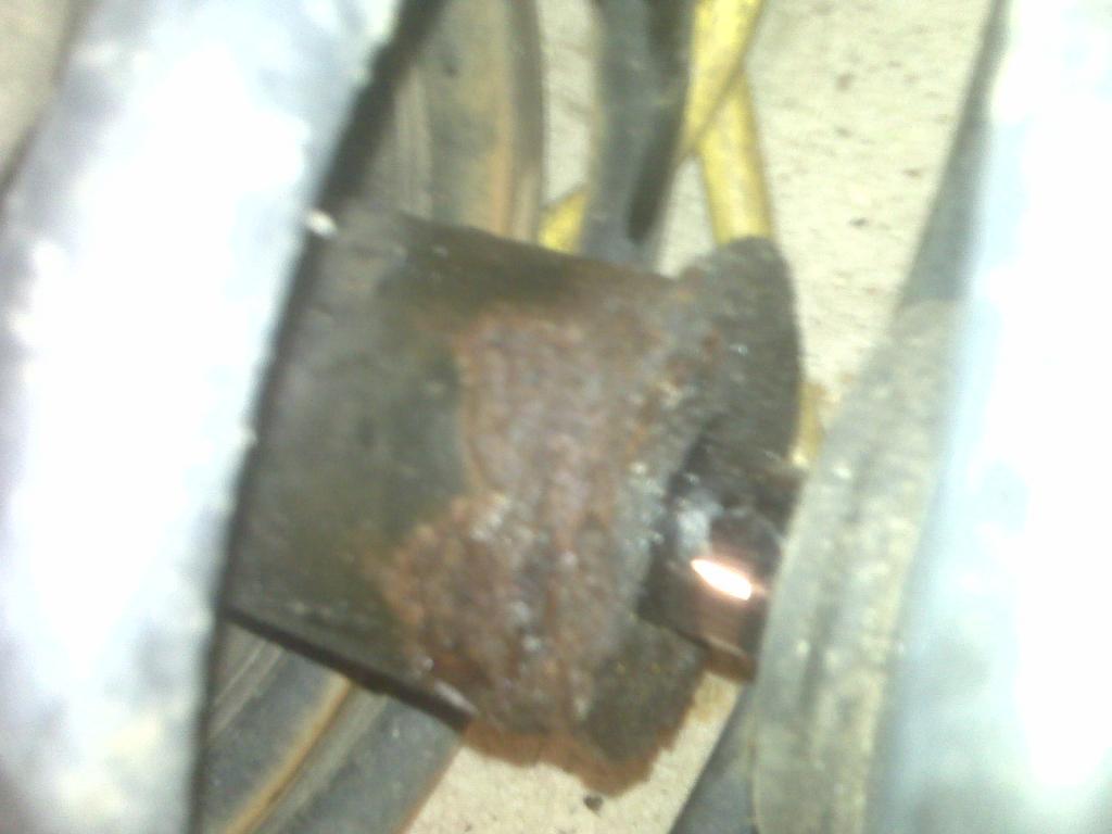

    im assuming since the collar is beyond corosion it would be in my best interest to locate new struts?

      the 87 struts will work just fine but if I were you I would just spray some PB Blaster on that retaining nut and let it sit for a day if you can. Just clean as best you can and try to hammer it off with a hammer and chisel. Its definitely doable.

          It can be a serious PITA man, hang in there. It took like an hour and a half to get one off once, with a table vise, and HUGE channel locks. But it eventually came out.
          Our E34 was the same way. That collar nut sucks sometimes, but you gotta have it.
          EDIT: and yeah, spray the thing with PB Blaster and let it sit for half a day or so. It works too.

            that's pretty bad , I wouldn't expect a hammer and chisel to do anything to those but peel off the metal. I did a set on my old eta a couple weeks ago put on a used set from a '87 325, which wasn't even as bad as yours and it took a 3 foot pipe wrench and a torch before one would budge.
            btw 88 325's and 84 eta's have a smaller strut housing than the rest of the e30's, iirc this doesn't matter if you are replacing with oem hydraulic shocks but if you go to bilstein sport gas shocks they won't fit into the narrower housings at least that's my understanding.

                Yeah save yourself the extra trouble if you can't get it off.
                If that's rust, then its probably permanently on there now.

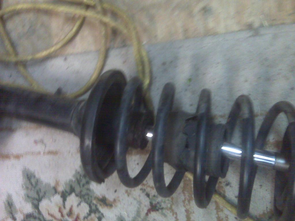

                        okay so i had to use the other struts, no big deal. i have them all torques together and assebled however the plate that goes onto the top of the spring is a few mm's above the top. i assume once installed and weighted it will seat itself down.
                        im using h and r race + bilstein sports.
