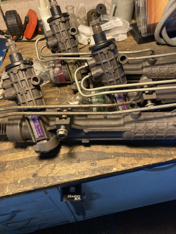

        Depends on what you call decent. Rebuilt after market seemed to be less available today and used ( junkyard) e36 / e46 are not far behind. If your not opposed to a used rack e46 330i are still in junkyards. OEM e30 I ran across one the other day and passsed on it. I had a leaky system and it turned out to be the fill tank / line connection. Below is latest haul of 330i racks.
