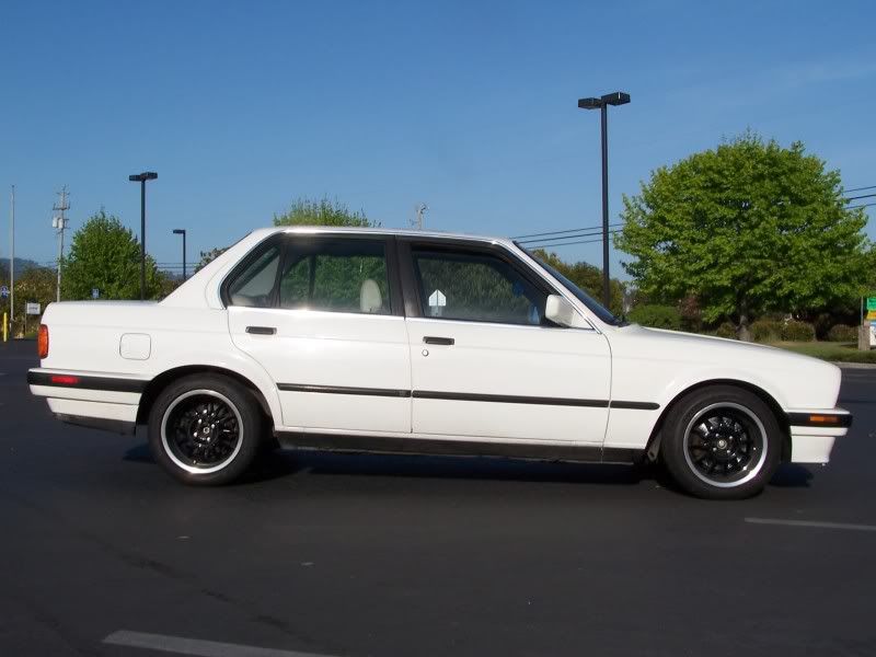

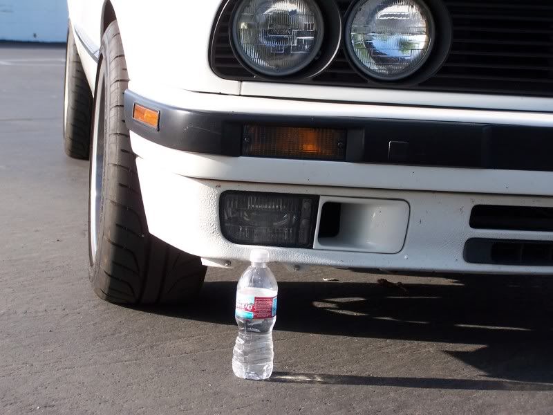

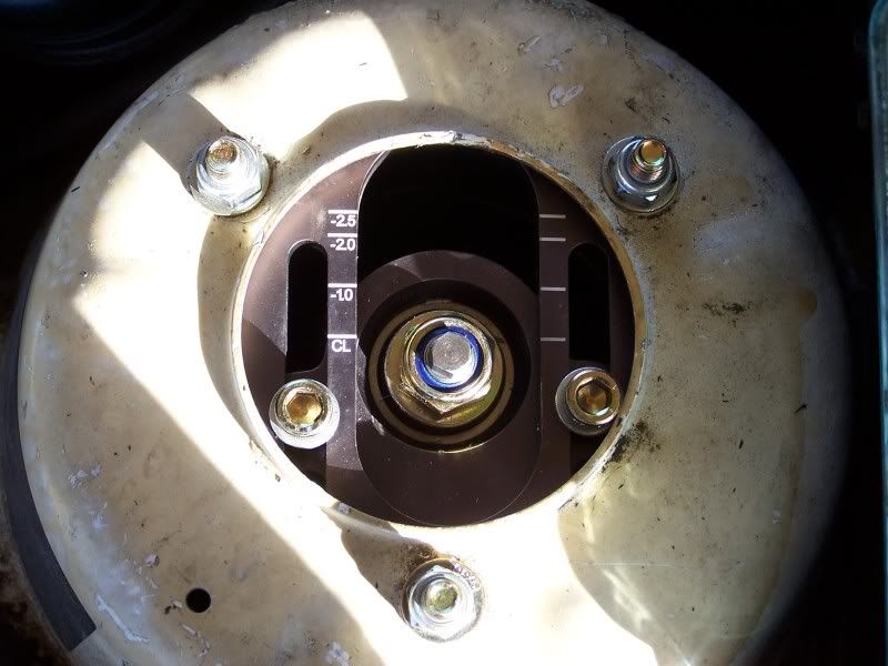

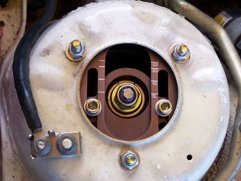

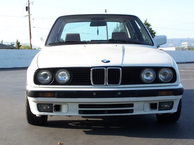

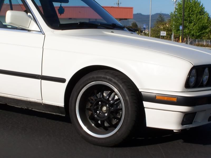

                  Here are pics of the plates installed:
                  Pics of the car:
                  Keep in mind that the rears are still stock.
                  I forgot to mention that I also have the m3 offset CABs. Regarding the post prior, are your plates the SpecE30 ones and what kind of strut/chassis issues do you speculate might be going on?
                  Thanks again!

                    Hmm. . . What size tires are you running? I have H&R race with Bil' Sports and my front appears to be quite a bit lower, and i have stock FSM.
                    -tim

                      • whodwho
                        • Jun 2008
                        • 1547
                        Turn the bearing plates around 180*, they are offset to one side from center.

                        • E turd
                          • Dec 2008
                          • 102
                          Thank you, sir. I'll do that ASAP!

                              Well your tires are undersized. So that makes up for some of the look. But the Plates should have a shorter stack height than stock FSM. Also make sure your springs are sitting on the pads/perches correctly.
                              -tim
