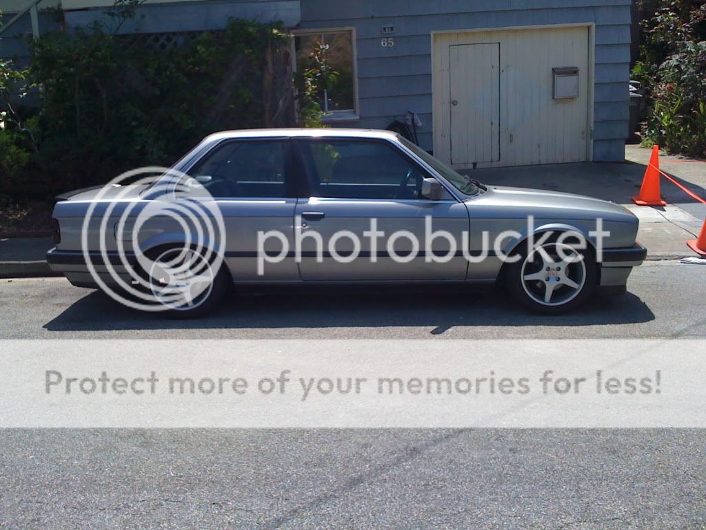

            Originally posted by E30SPDFRK
            Pics:
            s
            this is the height I want.
                That height is really easy to get, lol

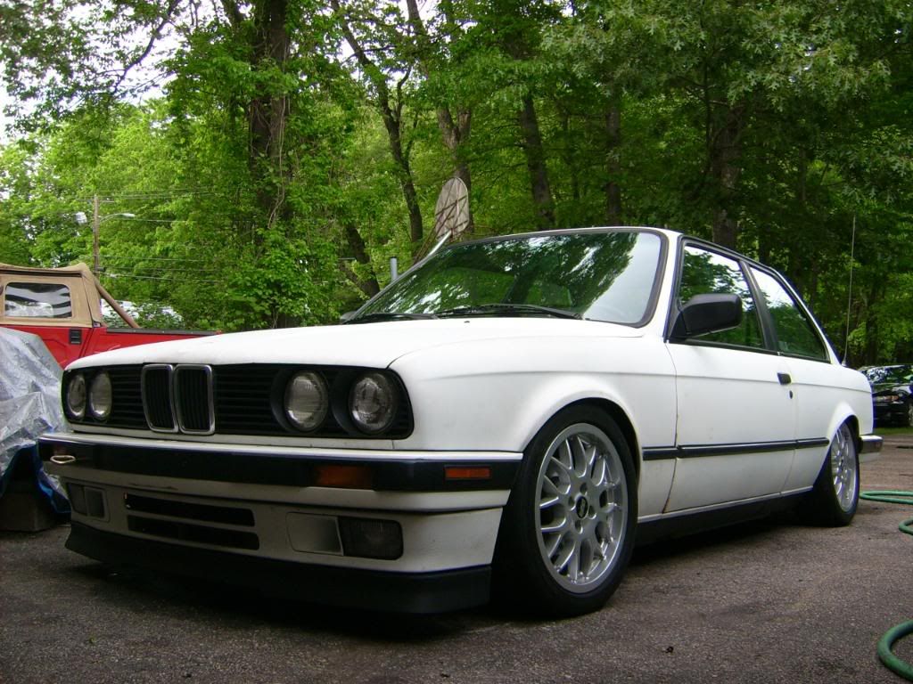

                            TBH gonna have to say my 60/50's look better then those:
                            This is with spring pads all around
                            -Alex

                              #44
                              His springs still haven't settled. What springs are those?
