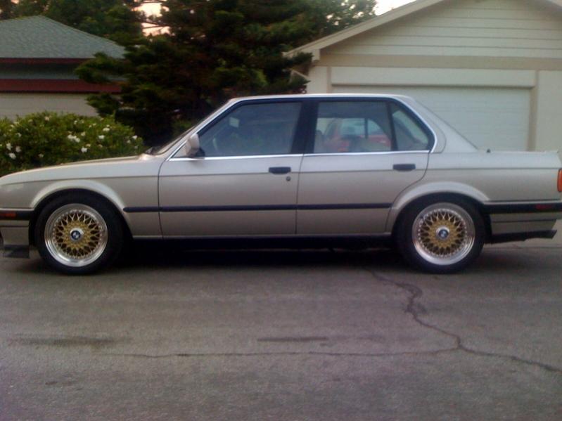

    So I got H&R Sport Springs and Bilstein shocks installed last week by a couple friends of mine who never worked on an e30 before. We did it in a garage and took us from 7:30pm-1:30am to complete.
    Anyways, this past weekend I hear this clunking noise comign from the rear whenever I drove over a small bump. And on top of that yesterday I started to hear a weird creaking noise from the rear. I first thought it was the spring noise but I don't think that's what it is. Seems like something is rubbing against something.
    First thing that came to my mind was that the rear shock mounts weren't tightened enough. They are the ones from Ground Control. However it said in the directions to tighten the top it said to hand tighten it and then turn it 360 degrees with the wrench. Is that correct?
    I took out everything in my trunk to make sure it wasnt the oem jack that was making the noise but it didnt help. I did a search and it seemed like the bushings were a common problem or swaybar links or something.
    Can you guys give me a list of things to check and what to check for and the proper names of the parts (in case I need to order new ones from pelican/bma/etc..). Thanks

    no suggestions? is it b/c i have gold wheels on a bronzit or is it because I don't have a coupe. haha
