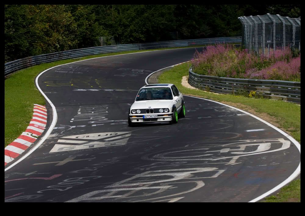

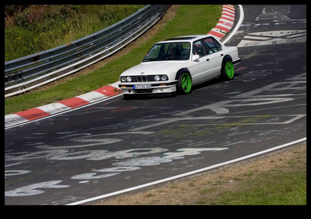

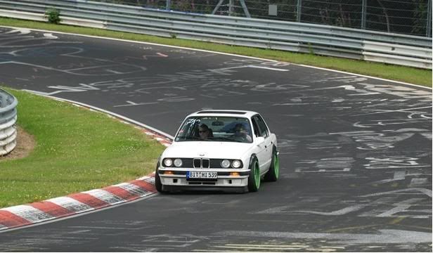

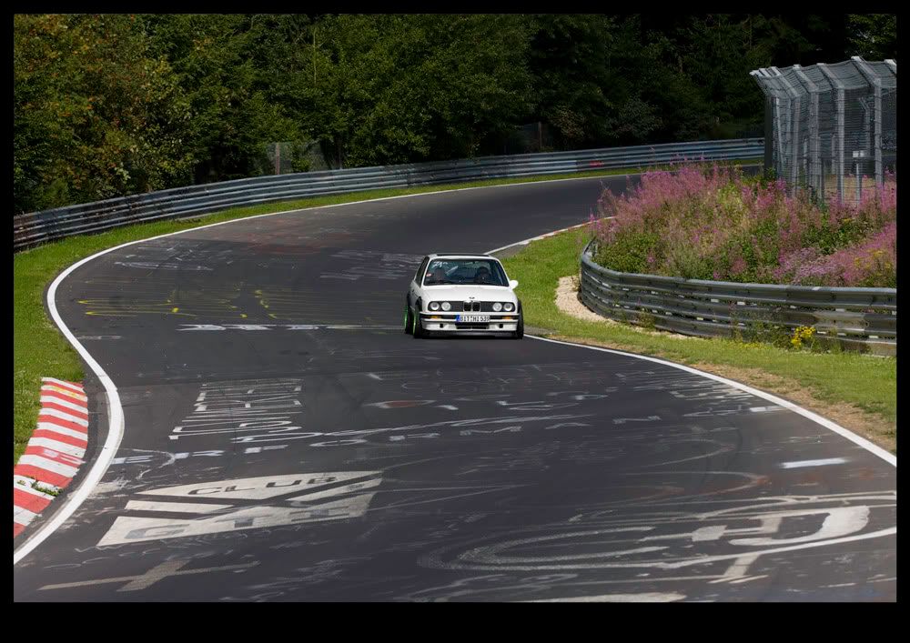

    and here are some shots of the car in action!

                  Car looks fucking awesome by the way.
