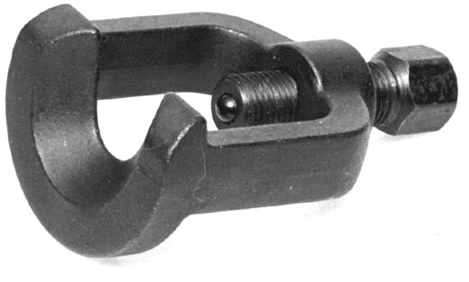

                      • Aptyp
                        • 6584
                        from http://www.sears.com/shc/s/p_10153_1...ord=ball+joint
                        one of my most favorite tools in the toolbox. Works on tie-rods and control arms.
                              this is the exact tool that i purchased to separate the ball joint from the strut. how the hell did you get it to work???????? i was down to 1/4" on the threaded bolt...and nothing happend...
