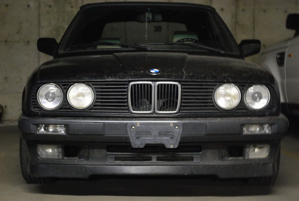

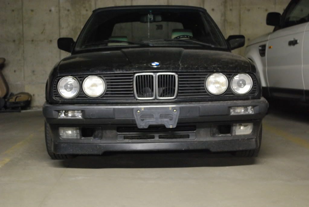

                        Pics!
                        Holly f-ing dirtiness Batman!!
                        I know, i know. my wife wont ride with me in it because of that. Which is more incentive not to.:mrgreen:

                          Looks like you're parked on an incline. J/K A side shot from each side would have helped a bit more. If one spring was shorter, by as much as you claim it to be, you would have noticed it during install. You could just lift the car off the ground and measure each spring , if you think that's the problem.
