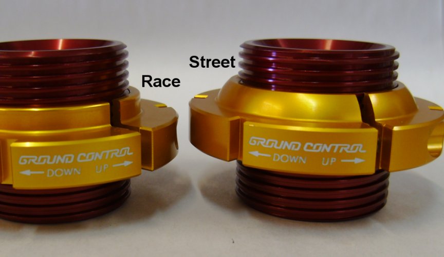

            1) The height of any GC rear adjuster is a very specific height, usually very short. The reason being that the rear springs we use have LOTS of travel in them. Lots.
            2) This is to retain (not get) better handling through consistency.
            Rear spring coilbinds=spring rate change=inconsistent handling.
            3)If we believe this, then also rear coilover hardware touching each other is bad.
            Rear spring hardware touches=spring rate change=inconsistent handling.
            Conclusion) Therefore, the GC rear hardware cannot have a very tall taper on top if used with a GC or Eibach spring because we want to avoid "Rear spring hardware touches=spring rate change=inconsistent handling."
            So that is why your GC rear hardware cannot be tall and tapered like others.

            In the world of race cars, there are compromises. GC chooses not to make the compromises in a manner that slows the car down, so the rear coilover hardware is short and rigid. (incidentally, the GC STREET rear hardware for the e30 is tapered and taller)
