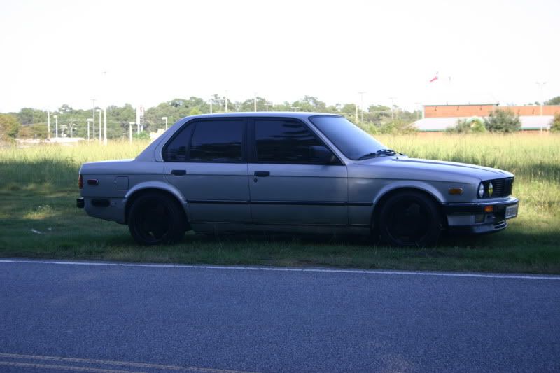

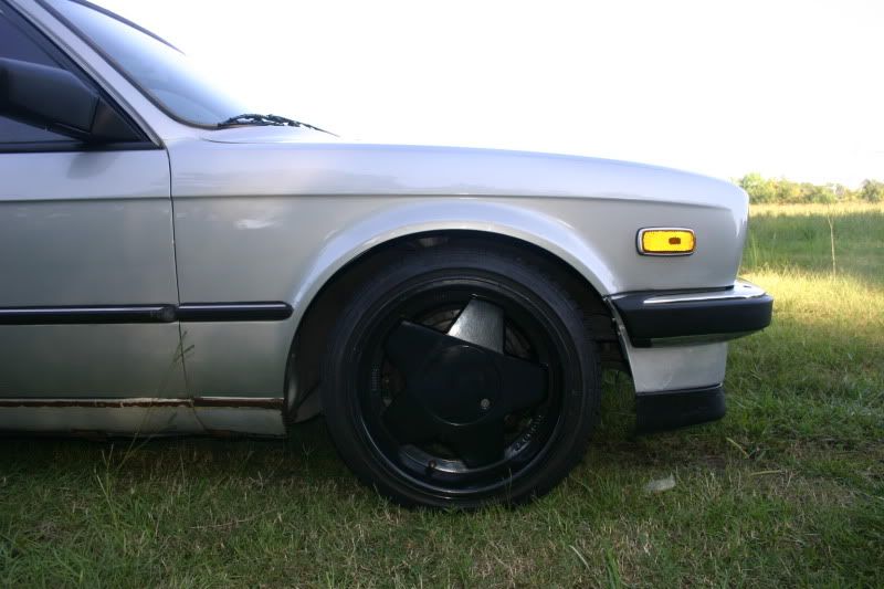

    I currently have Billy sports and Eibach pros on my car but it isn't enough.
    As you can see from the pics it isn't low enough. My other concern is how soft it is to me, even for a daily driver. I want something I can take to the track and get good response, but still put me as low as I want to be. I just wan to close some of the wheel well gap.
