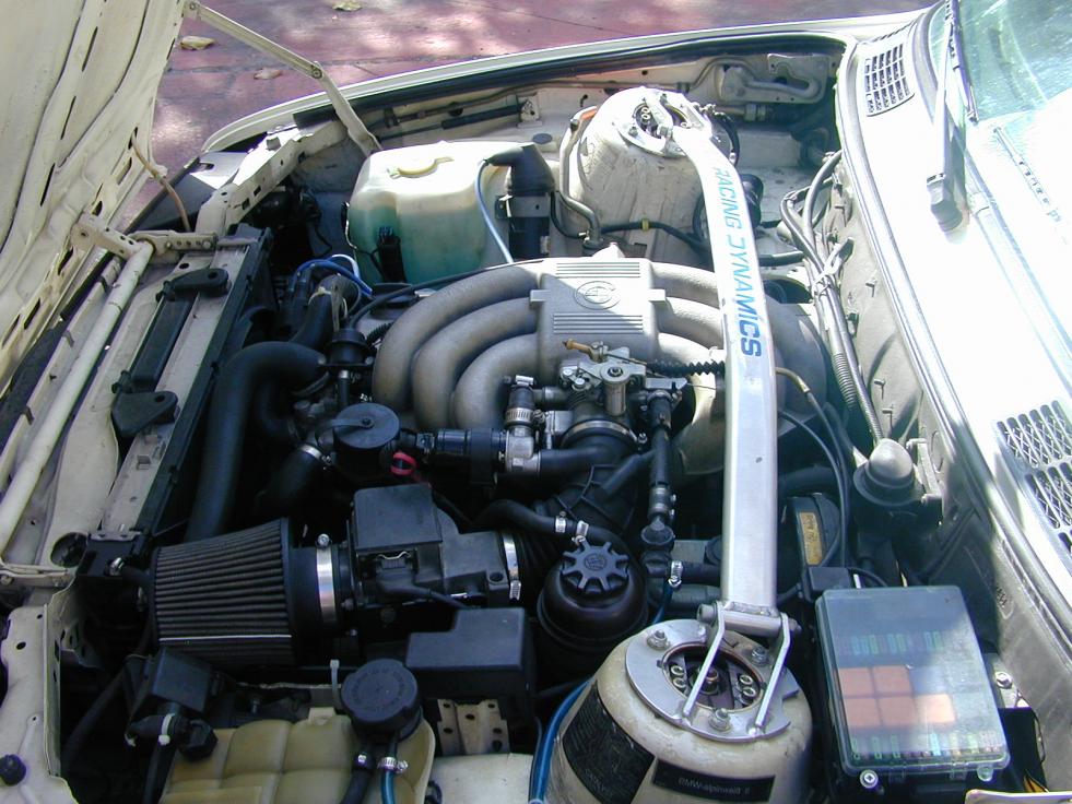

    Hey guys, I'm trying to figure out if a front strut brace really helps with handling? I've heard mixed reviews and don't want to waste my money if it's not going to help. Thanks in advance. :D

    from what i have come to understand. You will have very little difference in handling. It will though help prolong and keep your shock towers from possible cracking.

          a good one does stiffen the chassis, might make a hair of difference there.
          But it makes you look badass, and helps keep your car in one piece

              i had one on all my volvos (it got transferred everytime i got a new volvo). these are what i felt as gains:
              -very little physical gain in handling (maybe 1-5mph through turns, depending on original speed)
              -much crisper turn in
              -more stable when making corrections in a turn
              -better road feel through the steering wheel
              -slightly more comfortable ride
              -looks cool as hell
              also, the first time i installed it was on a car that i had removed the power steering. my first comment was "holy crap, it almost feels like i have power steering again!" i still don't fully understand that, 6 years later, but it really did decrease my steering effort.

                I would consider a 1-5mph increase through a turn a huge gain for something like a strut brace. I've been considering getting one too.

                    I think the strut towers flex too much to be truly beneficial on an e30. The convertibles have the gusset to the tower which should be put on all models. I'm working on designing a plate that covers the heater fan and can triangulate to the towers with a stress brace that should help with the flex more than just between the two.

                          If it helps stiffen any part of the chassis, why not get it?

                            I have seen so many of them that are cracked that it makes me think quite a bit of flexing is going on there.
