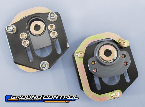

          These guys are offical Nor Cal Spec E30 sponsors. Spec Legal and one of the lowest I've had.
          • Hellabad
            • 807
            R3v Holiday Special, $299 shipped.
            R3V limited supporting vendor, Ground Control Suspension, now has Spec e30 camber plates on sale.
            Height:
            With the stock upper perch, as required by spec e30 rules, the pointy top of the spring is just millimeters away from the sheetmetal of the fender. The only way to get lower than this is to physically change the properties of matter.
            Center bearing:
            Made in USA, -12 aircraft bearing. (large) Documentation of source provided upon request.
            Materials:
            Powder coated cold rolled (102x) steel frame (caster adjustable) with grade 8 allen head bolts. Camber slider is hard anodized aircraft aluminum, 7075 T-6 .
            Instructions, spacers, adapters, reinforcement brackets with captured metric bolts, are all provided.
            Price:
            $299 shipped for R3vlimited members.
            Discount code is "plagiarism"
            It is important to spell this word correctly to get the discount, if you are unclear of how to spell this word type it into google.
