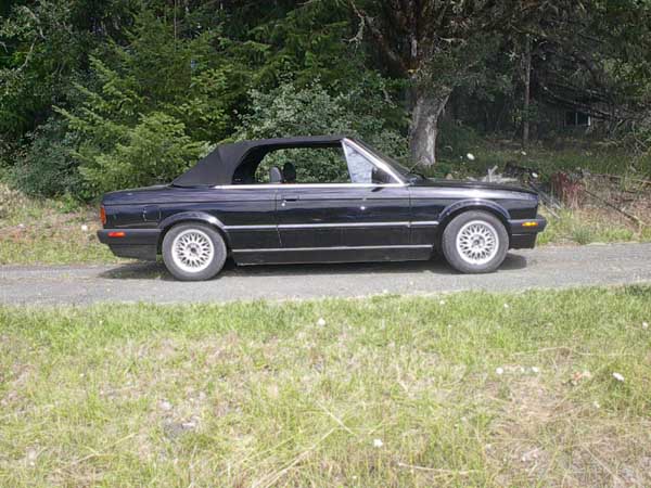

              my vert is sitting on springs and billys too, and all new front end
              very happy
              this coming weekend putting on a race skid shield and a strut bar ( should be here anyday now)
              rear busihgs and a fatter rear bar is part of this springs to do list
              ( as well as paint and install my IS trunk lid, with lip of course, with no third brake light and my front is lip) side lights were smoked and the center caps put back on just after the picture
              would love to afford some nice 15" euroweaves or other bbs
