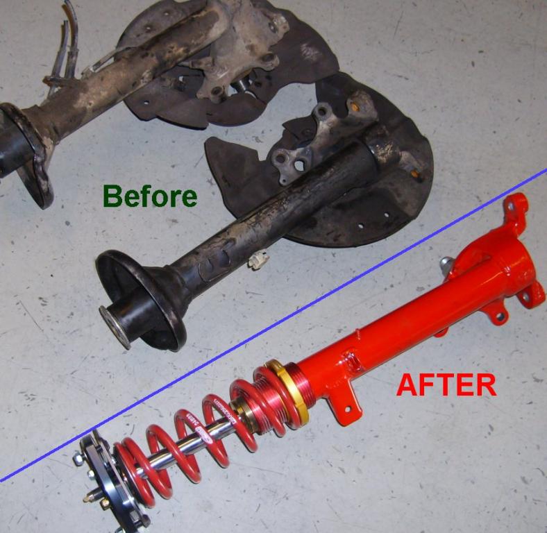

        This is the best picture I have right now. It looks pretty much like this. There are different ways to section the struts, and if you get a KIT, it is much easier than trying to piece it together yourself. It is also usually cheaper, and always works better.
