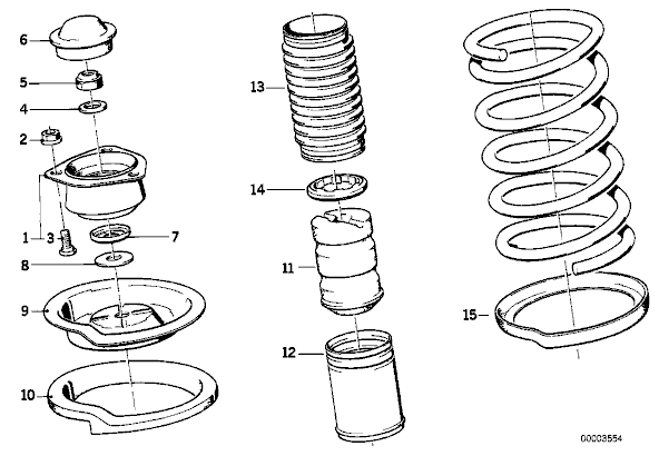

    Can anyone confirm the setup please? Is it #9 (upper spring plate), then #7 (dust collar), then the GC plate?

    The GC Spec E30 plates go directly against the upper spring perch (#9).
