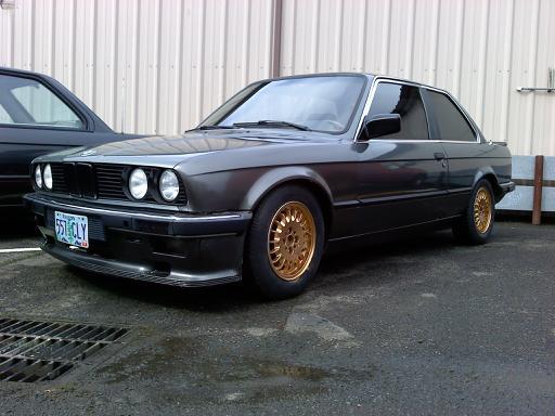

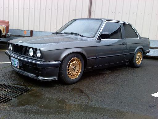

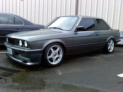

                  So i didnt measure before and after but it was a noticable drop. i tried to park in the same spot but my angle was off. you get the idea. I also got some new shoes and a facelift today! I know i have mismatched panel colors but one day it will get a full respray...
                  Before:
                  After:
                  With new wheels and a different valence (zender):

                    You put a zender over mtI ? lolz.
                      The mtech valence is in terrible shape, its been all hacked up to go on a db car. the zender is in very good shape and i have a few other zender pieces in the works, should turn out nice. And its not like the mtech went anywhere, can put it back on anytime.
