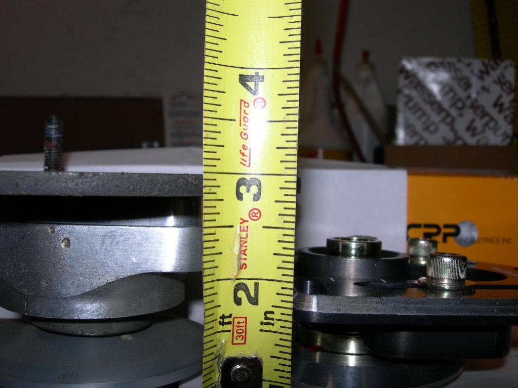

          Originally posted by mach schnell
          Will they reduce the ride height at all, compared to stock mounts?
          No, they actually raise the ride height up some.

                Difference between a IE street/track plate and a Ground Control plate with TC Klein upper spring perch.
