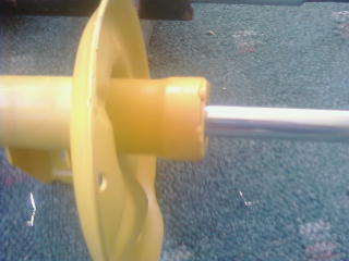

    Alot of people have done the ground control coil over swap on their struts, and I know a guy who has them on Billy sports.. so I found a sweet deal on a brand new early 325 (91-92) set of billy sports, since they have the swaybar tab just like an M3, and figured I could chop off the larger E36 spring bucket and throw some threaded adjusters on there for coil overs.
    Well... I got the struts yesterday and they are Billy sports but the cap that holds the insert in the strut tube tapers out to a larger-than-strut tube-size, thus making it Impossible to slide the threaded sleeve onto the strut.

        I started cutting the spring perches off these things today and messed up.. i cut them completely off and just left the factory weld for the perch... I had some cheapo EBAY coil over kit where I sliced the threaded sleeve in order to spread it over that larger top area, then figured I could keep it clamped together with the spring adjuster once its tightened up. well that didnt work out and after getting on the phone with jay and trevor at ground control, I realized I chopped too much material off. I should have left some of the spring perch on there because they can only make a threaded sleeve that fits the size of the larger diameter at the top, and then it would rest on the spring perch..

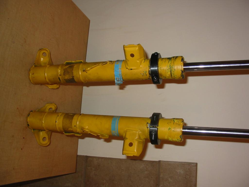

              this is all I need. clamp to strut, remaining weld "bead" from factory perches will hold it up, they have them in 50 mm (bilstien strut is 50.5mm.. i can take off the .5 or request it to be that size) and this has an outside diameter of about 3 inches. perfect size to hold up the threaded sleeves
              • bimmer630
                • 1228

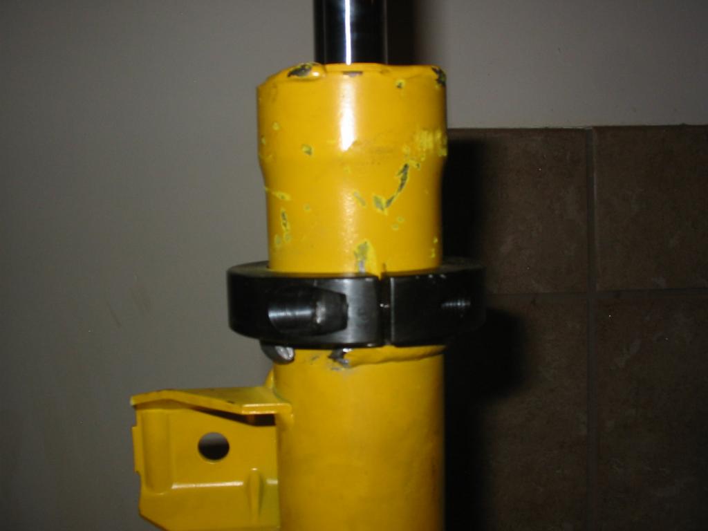

                I've come up with the solution. These split shaft collars were only around 30 bucks and they will provide something for the Ground control threaded sleeve to rest on, and the collars rest on the welds. I put loads of locktite on the threads and I'm even thinking of just welding the two halves together to make sure everything stays put. (I wont be welding ON the strut so I dont see why it wouldnt be safe)
                Then i'll paint everything to make it look shnazzy..
                The sleeve is sized to the larger upper tube section. Ordered the GC kit yesterday, should be pretty cool once its all together.
                These are BRAND NEW struts if you can believe it.. they were being kicked around a bit and the paints been ripped off in the process of cutting off the perches. They are early 91-92 E36 struts, so I get the M3-style swaylink mounts and the struts were half the price of M3 ones. I do wish I knew about this larger upper tube before I bought them though

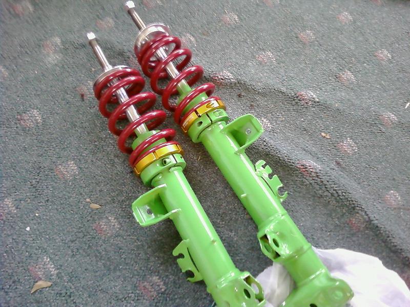

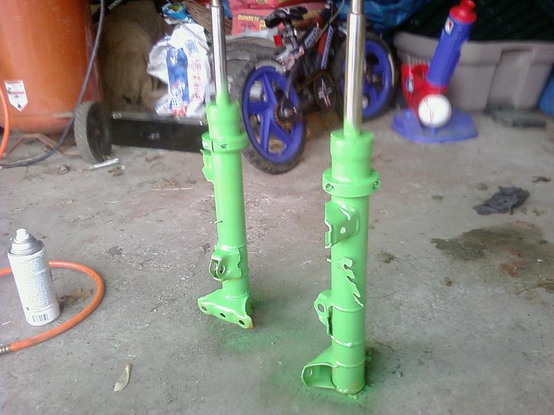

                        I got the kit today but the threaded sleeves werent the right ID to fit over my struts. Jay at Ground control was cool on the phone and hes shipping the correct sleeves out asap. I put everything together without the sleeves to show what im goin for with this setup
