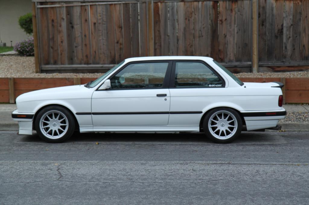

    1989 325i
    HR Sports with Bilstein HDs
    Hartge Type A 16x7.5 et25. 15mm spacers all around so it's at a +10
    Tires are Hangook RS2 215/45/16s.
    I'm rubbing on the rear passenger side at dips and left turns but never from the left side (even on right hand turns). The fender roll seems to be even on both sides and there's space, which is why I thought that the cause was a bad shock. I found another used HD shock on craigslist and put that on. The rubbing isn't as bad but I still get them on dips and on some left turns.
    Do you guys think it's the shock again that is going bad or could it be another issue? Any advice is greatly appreciated. Thanks

    I am not certain but I do not think Bilsten HD's like lowering springs. Aside from that I would suggest putting thicker rear spring pads in to raise the rear a bit.

      hmm where can i find these thicker spring pads for the rear? i hate the reverse rake look on my car. I even have the 15mm drop hats on the front

        they have them here http://www.pelicanparts.com/BMW/cata...pg6.htm#item40
        From what I understand, there were different thickness pads from the factory so you can get them at a dealer if you dont already have the thickest (15mm?)

          hmm ok ill have to look into it b/c i dont know if i already have the 15mm ones. Hopefully i dont, so that i can raise the rear up a bit. thanks for the info
