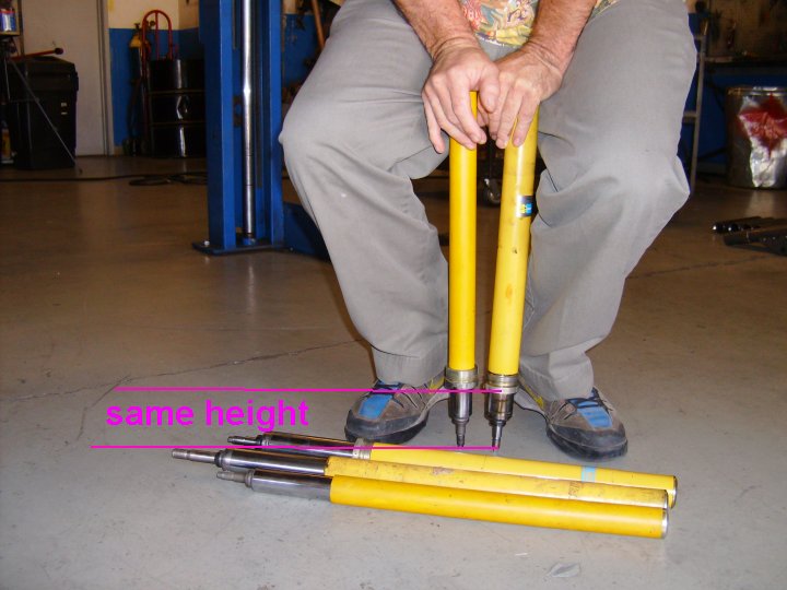

        pic attached of compressing Bilstein Sport and HD fronts to show most Sport and HD bottom out at exactly the same time too.
        PS. The "drop factor", which is what I call "droop", is 20mm shorter for sport, than HD (on paper, but in real life they can be more than 20mm. I don't know why.)

          pic attached of compressing Bilstein Sport and HD fronts to show most of them bottom out at exactly the same time too.

              That 20mm thing is interesting. I had Bilstein HD's on H&R springs on my E34 touring. It would bottom out over sharp bumps. Then I switched to Bilstein Sports, no more bottoming. Then I added 15mm drop hats, now it bottoms out on sharp bumps again, but less severely than before.
              As far as I know, VW rabbits, e30 and e21 have the same bottomed out height for sure. Some others, like e34, I am not sure. They made so many for so many years, that I only will try to help someone if I am sure of what I am saying (see pic)
              Droop is NOT the same as bump.
