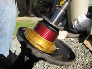

        Sorry to bring this up again, but what exactly needs to be welded and how neccessary is it? The reason i ask is because Im going to school where theres a lot of snow, so adjustability is important to me, and i dont really have easy access to a welder.

          There is NO required welding to install the basic kit.
          You can trim the factory perch in front for added lowering and tire clearance if needed.
          Like this...
          Suspension tips here...
          http://www.r3vlimited.com/board/album.php?albumid=757

            All right good to know. I doubt that would be necessary as I dont like it to be too low anyway, just enough to eliminate most fender gap.

              i wonder how low it goes without cutting the perch? anyone have pics?
              • joshuafr
                • Jun 2010
                • 143
                I think the website says 0"-2.2"

                • DRTSRFR
                  • May 2008
                  • 1836
                  Here's the car after the install all the way down in front...

                  • psyber_0ptix
                    • 904
                    ^ it would be helpful to identify what length spring and possibly springrate you are running.
                    Probably wouldn't matter too much, but to paint a more complete picture.

                    • DRTSRFR
                      • May 2008
                      • 1836
                      This car's running 6" 440 in front and 5" 700 in the rear.
                      I've got 3 E30's and have experimented with a number of rates. This combo is by far my favorite...very well balanced, firm but not harsh.

                      • joshuafr
                        • Jun 2010
                        • 143
                        That looks really good. I wouldnt go farther than that. But did you choose those spring lengths? Im a little confused by that.

                        • psyber_0ptix
                          • 904
                          if you consult with GC, they will treat you right. Others would mix and match combinations of rates/lengths until they get what they desire for the car. Be it performance or stance.

                          • psyber_0ptix
                            • 904
                            any sway bars?

                            • DRTSRFR
                              • May 2008
                              • 1836
                              ...stock bars on this one.
                              The lengths were suggested by GC. There's nothing shorter than a 6" for the front in 2.5" ID.
                              Why are you confused?
