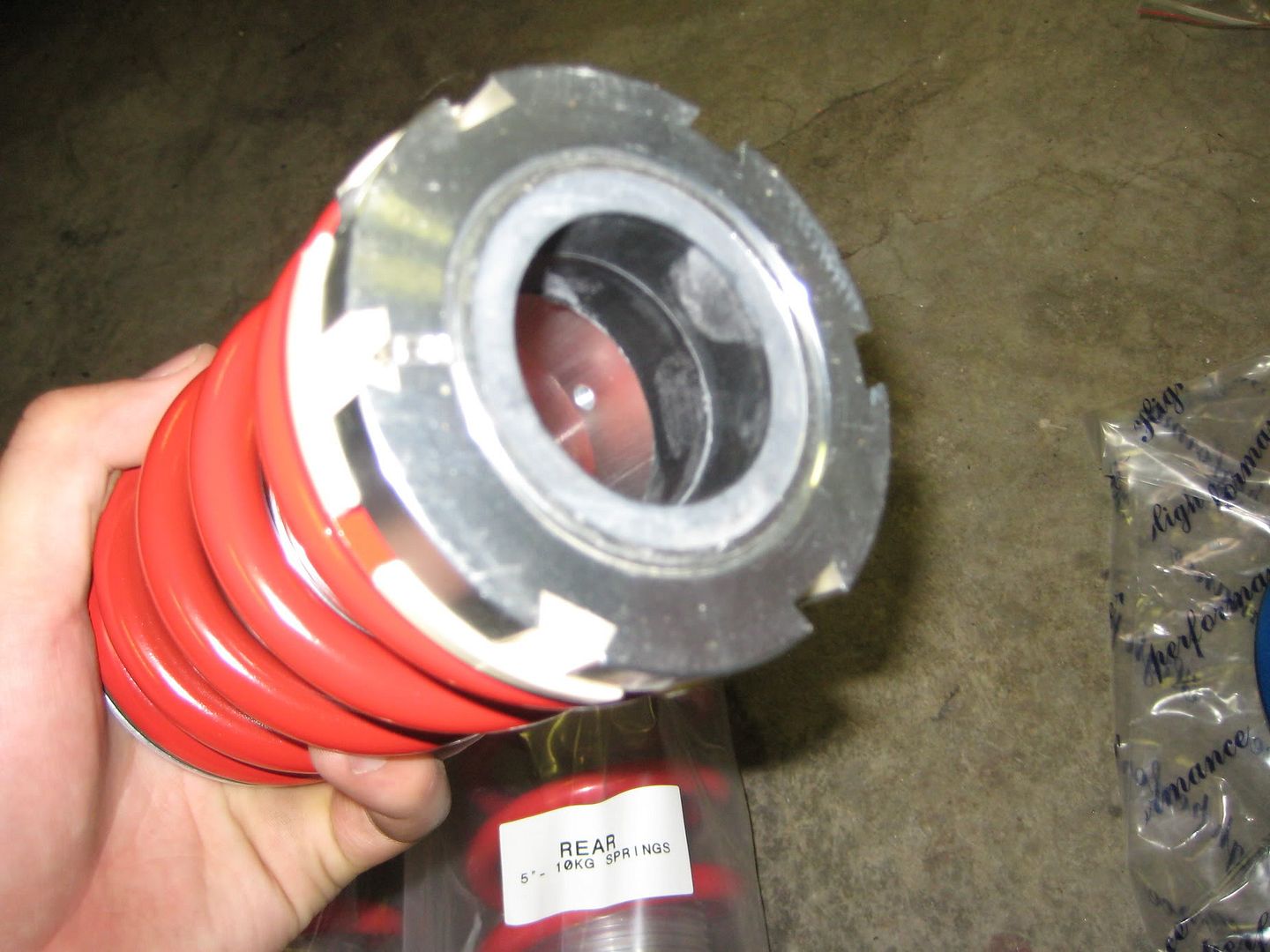

    To make the rear adjusters fit snugly over the nubs on the trailing arms I wrapped them with electrical tape, the same was done for the spring hats on the top.
    In the front I removed the stock spring perch leaving only a nub around the strut body that the new adjustable spring perch would sit on. The fit of the adjusters on the strut body is good, but not quite as good as with the ground control parts. Once again I wrapped the strut body with a little electrical tape to make sure everything stayed in place snug, although if I remember correctly not much was needed.

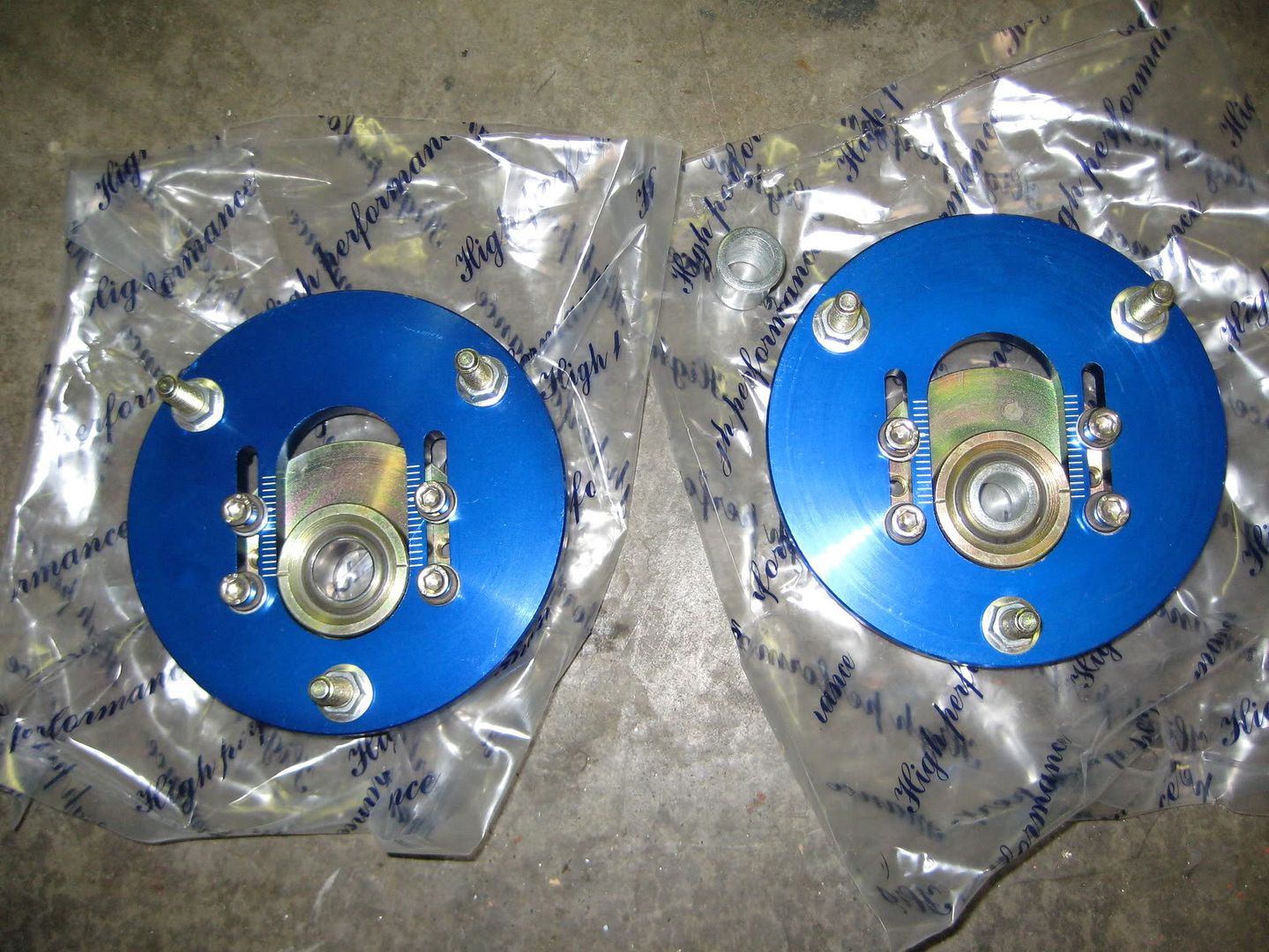

    To install the camber plates a spacer needed to be placed in between the spring hat and the spherical bearing in the camber plate, this spacer allows the spherical bearing to do its job and allow the strut to pivot about the spherical bearing. Without it the spring hat would sit directly against the camber plate and the suspension would bind.
    My spacers were made from aluminum and CNC cut (my friend operates a CNC lathe at work and we joke about them being $100 spacers for what It would have cost to have the shop make them). If this option isn't available to you which I suspect it isn't for most of us, you could probably get away with using a few washers and grinding down the outside until they reach the proper OD to clear the camber plate body. This problem is very obvious and its likely that the cosmo kit is suppored to come with something to solve this problem, although I never bothered to contact customer support so I cant say weather or not this was a fluke and do not know how helpful customer service would have been had I contacted them.

    The camber plates

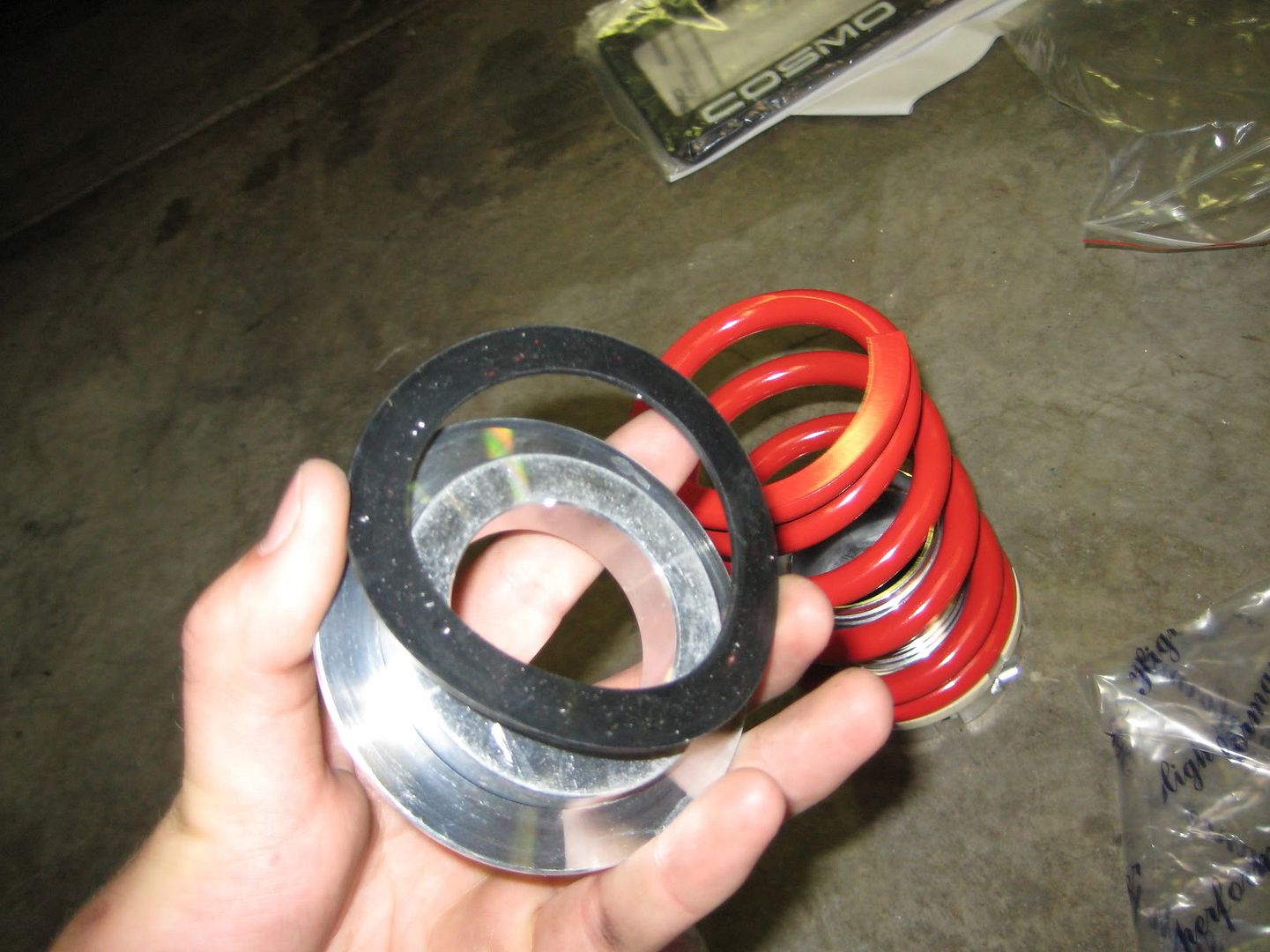

    The rear spring, adjusters and hats
    The front springs, adjusters and hats
              what are the approx dimension of your spacer ? ht x dia ? do you think a spacer would be required if using stk upper mounts ? I have a set that was replaced with GC unit but no info. Thnx for write up

                If your using stock upper mount they sell a different camber plated designed to work with stock upper mounts. I'm not sure what the differences are between the two designs though.
                The ID of the spacer was matched to the OD of the top of the strut so that it slides just over the threads, then I remember the OD being about .200" or .300" larger than this measurement (diameter, not radius). Then the whole spacer was about .250" long. I'm pulling all these dimensions from the top of my head, I cant remember the exact dimensions used but its not all that important. The spacer just needs to take the force from the spring hat and put it into the spherical bearing as opposed to letting the spring hat just sit on the camber plate body. Any piece of metal that can accomplish this should work.
