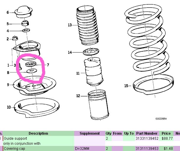

                        These need to be there, and right side up too. But if you drained the rack and plugged the holes, you may have another problem too.

                            I'll check that they're there tomorrow, thanks for the diagram. Didn't drain the rack, but the holes are plugged. I've never had an issue with doing it that way on any other cars I've owned, so I figured that wasn't the cause. I'm thinking it's got to be the washer, or lack there of.
