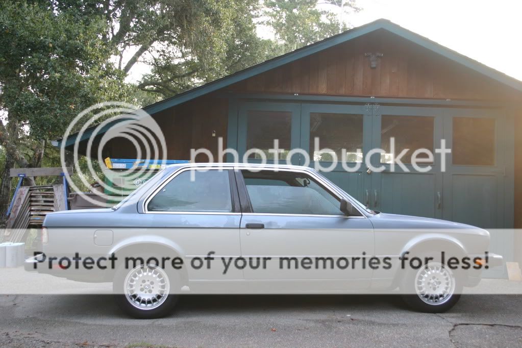

    I feel like my e30 is above stock ride height which would be somewhat depressing haha.. does this look stock to you?
    somebody sell me some coilovers..

    That looks hella high.

        its a 318i?

          what size are your tires?

            325e 84'

              Tires just look undersized.

                what is the stock tire size on a 325e.
                  im gonna say 165/65/14
                  • MR 325
                    • 37833
                    Stock sizes were 195/60/14 and 195/65/14. Not exactly sure what year was the cutoff when they switched sizes.

                      yeah the tires in the picture are 195/60's

                        Tires are a little undersized, and early 318s and 325e's were really high...

                          boioioioioioioioioiiiiing
                          no thats probably right though. since early models have the higher rear wheel well they can appear higher than lates

                            thats how high my 86 eta sat. seems normal to me

                              Tire size is correct for an '84 (195/60), they didn't switch to 195/65 until sometime in '85 or '86.
