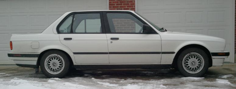

              Sounds like C/C plates are not an absolute necessity. I'll slap the Eibachs on this weekend and just set the toe with toe plates in the garage.
              Haven't researched all the C/C plate options but for $200-$300, that goes a long way in 14" tires assuming I can get at least 30K miles without the plates, from Fuzion HRi's.

                        I've put springs on 6 different cars over the years. I've never been so pleased as with the results on the 325i. The car is amazingly more fun to drive, unlike any other time I've done this!

                              No way! She is now perfect!
