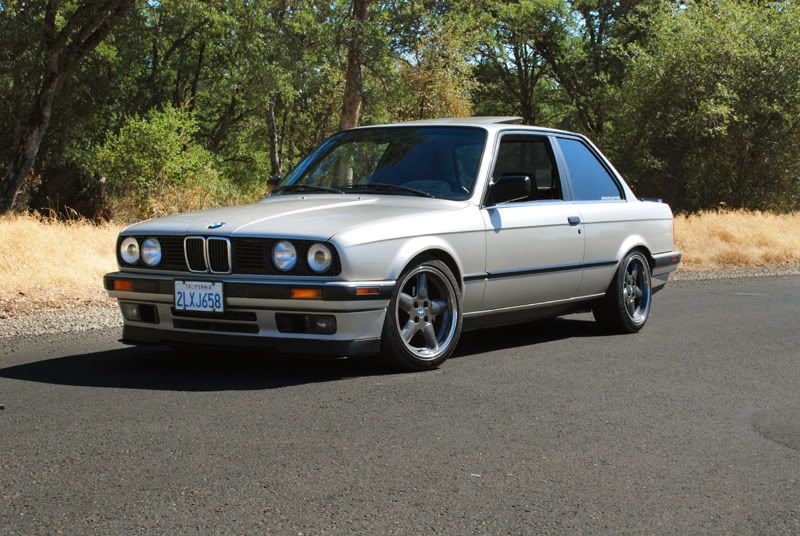

                        This drop I would like for my e30. Ride quality?
                        This is a car I purchased with a basic kit already installed on stock dampers, which were blown, so ride quality wasn't so great. I installed our complete system in this pic.
                        The pic in my sig is on the complete system with a 1" section.
                        Here's the bronzit about half way down on the complete kit...
