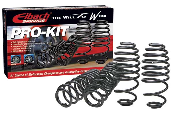

    :DI just got some Eibach springs but I never replace springs before
    Have any one replace something like this before , please give some recomendations, what tools I will need or the best way to do this job. Thanks!

    You need spring compressors. Did you buy sport shocks to go with them?

      Air tools, while not a must, are extremely helpful.

        I didn't buy the shocks , I have a low budget :( the opportunity to buy the springs show up so I didn't let it go:nice:

          If you use those springs with new, or nearly new, OE shocks, the shocks won't last long (perhaps only a few thousand miles). If the shocks on the car are OE or equal and have 60k or more on them, they are already blown out. Best to hang onto the springs until you have the funds for a set of Bilstein Sport shocks.

              Can I still use the springs with the OE shocks and when they get bad replace them with the Bilstein? Thanks..

                Are your OE shocks new, or only have a few thou on them? You can use those springs with the shocks that you have, but note what I said about the life of OE shocks (new and used).

                  a few thou..
                  What you are telling me is true man but I can wait to see how my car will look a little lower

                    The Eibach springs are install
                    Before
                    After

                      looks good without that huge gap.

                        The springs I got them for 100 bucks , to this guy that never install them
                        and I install them with my friends help , he has one of those hidraulic spring compressor so it was ffast and easy
