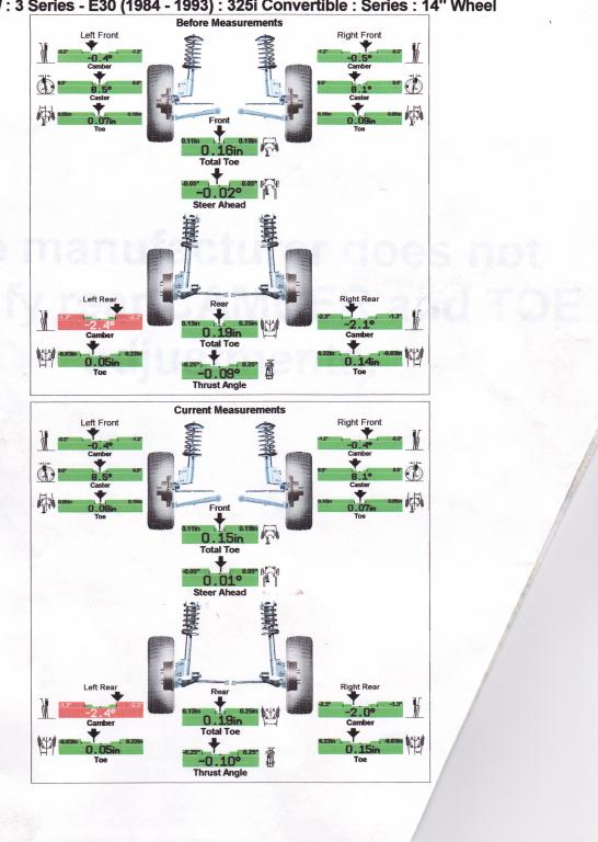

    What did the alignment sheet say? Is everything within spec, or no?
    • hooken m
      • 1537
      does this look about right? im not 100% sure of the correct specs

        The car is probably pulling because the rear wheels aren't correctly aligned. The cause of that could be nothing more than worn out rear trailing arm bushings. But there could be a bent trailing arm.

                fix your thrust angle, duh.. when aligning a car, always start with the back, too.
