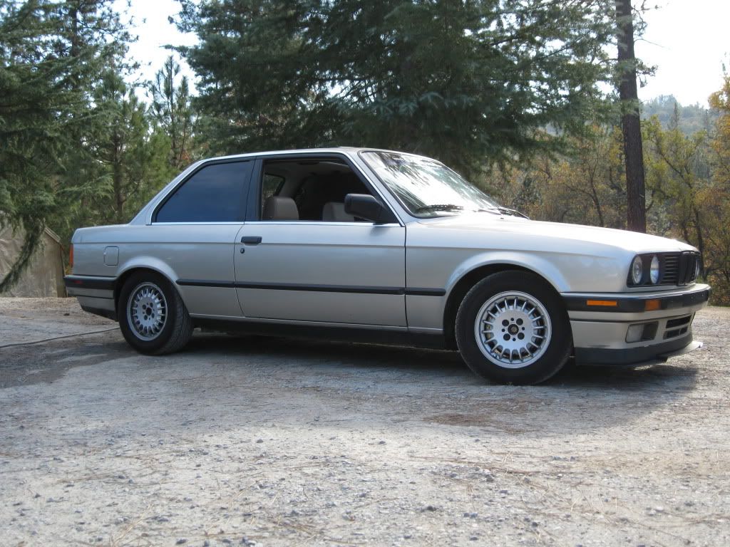

            Here's an '89 on stock dampers all the way down in front without the perches removed...

              Alright, thanks a lot. Just ordered mine a couple days ago, service was excellent. Im assuming w/ Bilsteins it would be a lil' bit lower? The perches appear to be in a different spot.

                The perches are in exactly the same location. The dampers are "inserts" and all utilize the same strut housing.
                If you have Bilsteins, you may be riding on the bumpstops at this height.
