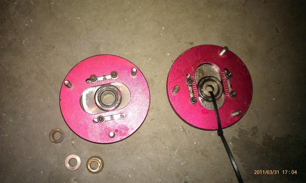

      A member on here pm'd me about the following plates he has for sale. To me they don't appear that the outer three bolts that bolt to the strut tower are in the same place as on an e30. Any input on this? Maybe I'm looking at it wrong?

        All I know is those Mookeeh guys must really like Metallica.
        paint sucks

              they might bolt in but it will give you camber and caster when you adjust since it will be on an angle
              I wouldnt get them, or if i did I would drill and tap and put the mounting bolts/studs in the correct locations.
