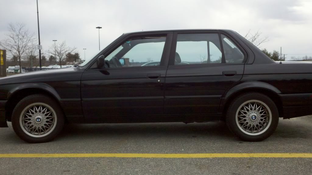

              Here is mine (stock height):
              The drop on this car is pretty much what I'm looking for, except a c hair lower in the front:
              From the suspension height thread, mtech springs I think.
