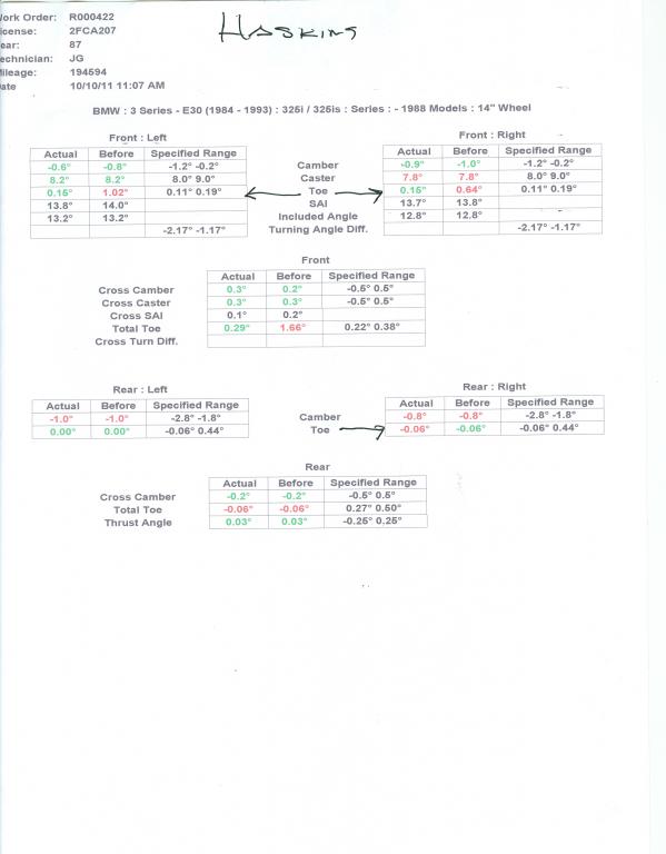

        alignment Q
        I just had front control arms, struts, strut monts replaced. Only non oem pieces were two e90 drop hats. Can anyone tell me if I need to do anything diffferent based on the alignment numbers my tire shop gave me.? Also do I need to have the rear end aligned ? Thanks
