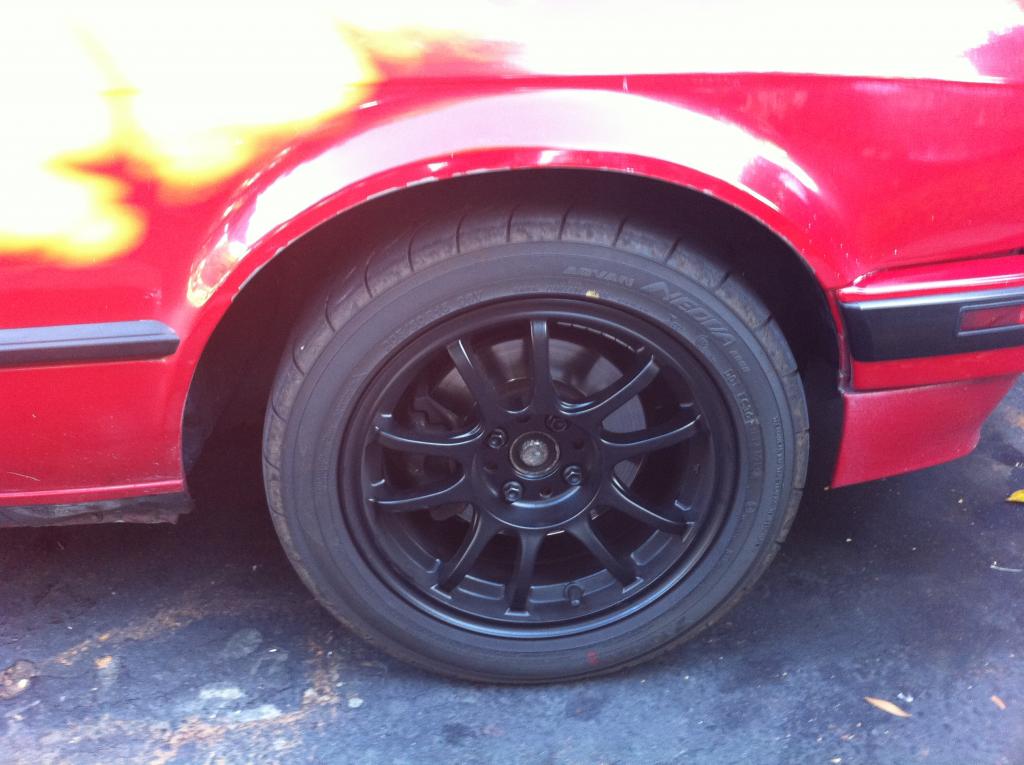

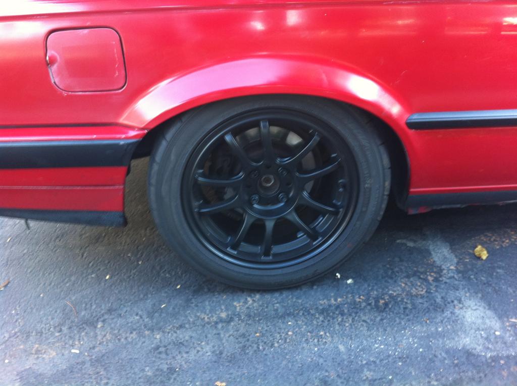

    I just picked up another E30 this week, and it has a set of GC coils on it. This is my first experience with coilovers. I adjusted the height in the rear fine. When I went to adjust the front, the passenger side collar was about half way up, and the driver side appears to be all the way down.
    The car has IE camber plates on them, and they look pretty beefy. My question is that it doesn't seem very low in the front (like at all). I had a previous e30 with IE3 springs and GC spec e30 plates, and the front seemed significantly lower. Do the GC's not go very low, or are the IE camber plates just too thick?
    Pics attached for reference

    Show us how they were installed..
    Take a pic with your wheel removed.

      My experience with IE plates tells me that they are REALLY thick. They are about the same height as stock upper mounts.
      The wheel gap in front is horrendous. Im with Abby. I think the fronts aren't installed correctly at all. Even with stock upper mounts, I was still about a finger gap between tire and front fender.
      It also may be a bad tire size choice for that wheel that is playing a trick on the eye as well. Post up some pics of the tire off. Make sure you get a picture of where the threaded collar meets the strut shaft. Ive got my money on the fact that the previous owner just threw some threaded sleeves over the strut body and didn't cut off the stock lower spring perch. Thats the only real thing I can think of that explains that much fender gap.

                        get some pictures up so we know what youre seeing. We will be able to help better after seeing pics.
                        Measure the spring or take the part number off of the front spring.
                        Also, we need to know if the front modification was done correctly. Did the PO cut the stock lower spring perch off? Or is the spring and adjuster just sitting in the stock spring perch?
