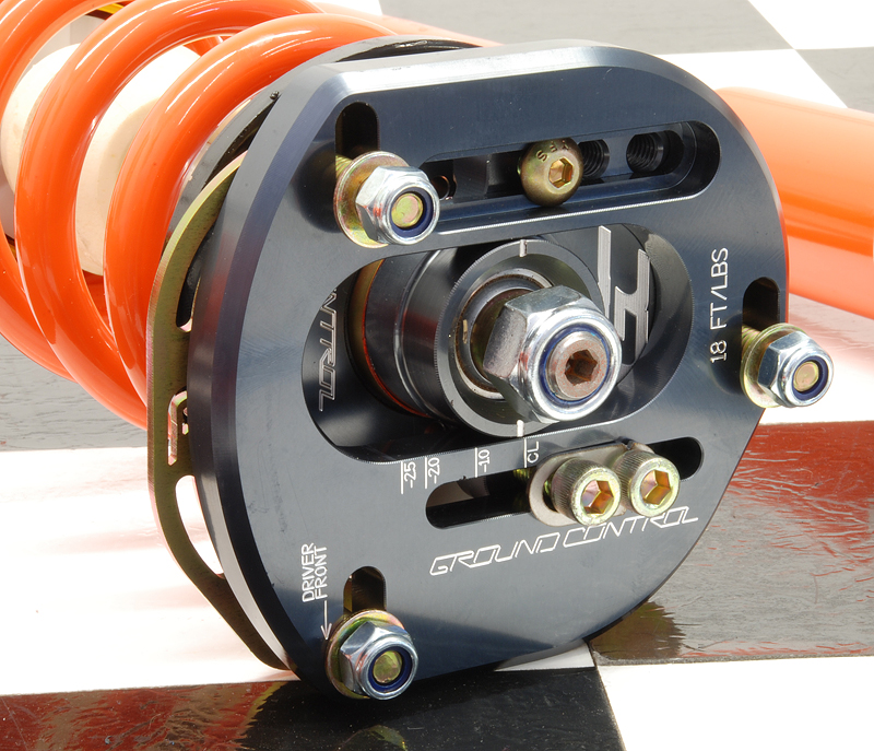

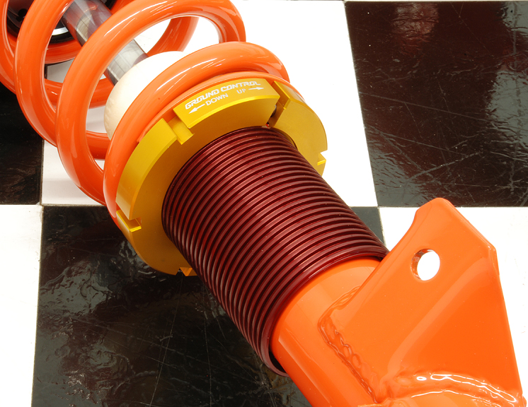

                  Looking at the original title of the thread, I purport THIS to be a work of art.
                  Art is in the details.
                  Some art you can see.
                  Such details as a threaded sleeve that is made for an e30 (no raw aluminum).
                  Some art you can't see.
                  Such as German bearings that let the spring "steer" when you turn the steering wheel.

                    For comparison, if you do decide to purchase a GC kit for $399, here is what you would get:
                    Aluminum upper perches to fit Bilstein and stock upper mount.
                    Eibach spring, to best match Bilstein.
                    Weld on lower mount, or no weld mount (your choice)
                    Threaded tube, specific length, anodized both ends.
                    One piece threaded adjuster with pinch bolt ( no jam wrenches)
                    Rear upper nylon spring seat, with o-rings.
                    Press on rear arm e30 threaded block.
                    One piece, CURVED threaded adjuster with pinch bolt ( no jam wrenches)
                    Plus actual shock dyno results, and experience to minimize Bilstein-coilover problems.
                    Parts are in stock, and can be shipped the same day. I do realize GC costs a little more than alternatives, so you have to decide what it is worth to you for a lifetime guarantee from a company with liability insurance, no waiting, and parts made specifically for an e30 with Bilsteins.
