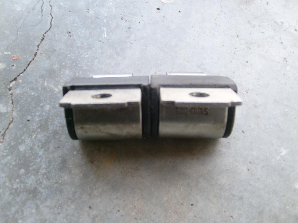

                  is this the rear sway or front??
                  cause i had trouble getting my rear 19mm sway to fit also..i ended up sanding down the back of the bushing so the bracket would bolt down. thats what the suspension techniques instructions said might happen..
                  in the pic you can kinda tell the difference.the one on the right was sanded down more flush with the new bracket
