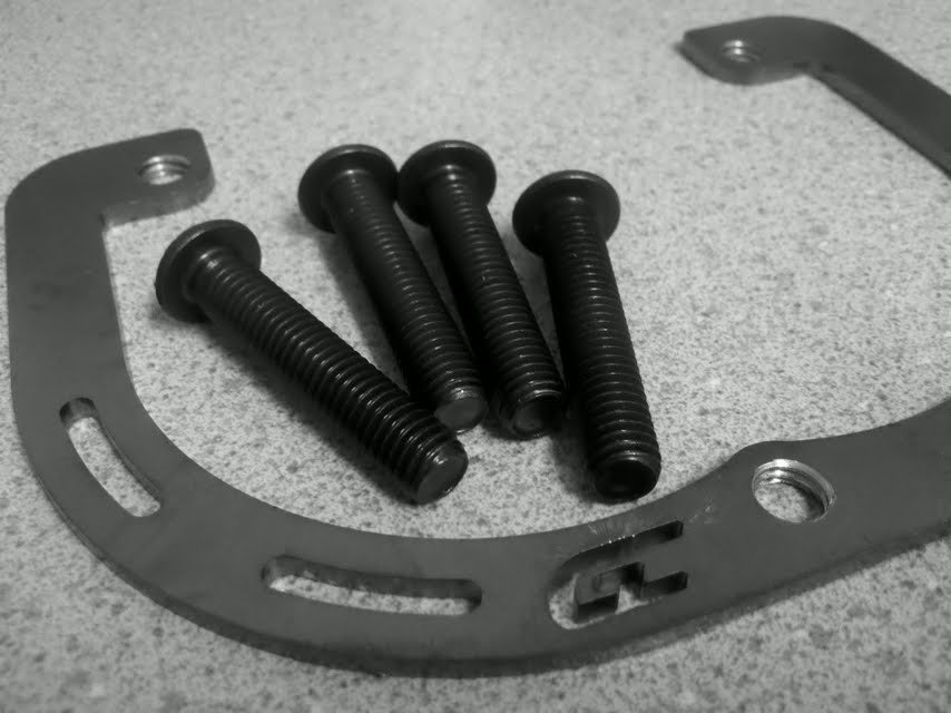

              My name is Jay. I'll explain how this could have been overlooked (and you can also see how this will never happen again)
              The GC plates with the stock diameter springs are fairly new. We have been building the race plates for various classes for many many years, but this is new.
              If you look at the pic below, you can see a raw GC bracket for a camber/caster plate. Look at the bolts. Those are grade 12.9 forged head, rolled thread extremely high quality bolts.
              Now look at the end of the threads. They are inconsistent, which is the nature of this type of fastener. The threads are not intended to reach up and cut into the radius below the head, to retain strength.
              Some camber plate manufacturers just weld the bolt into hole. GC found this to be very weak, so we thread them in, and THEN weld them.
              This means: They screw in different depths before they stop.
              Well, long story short, Sometimes the bolts have hit on the street perch. We now sort the street brackets separately, and you can can be reassured that "Apps" discovered a problem, GC found the cause, and implemented the changes to prevent this from happening to anyone else.
              And that's the truth.
