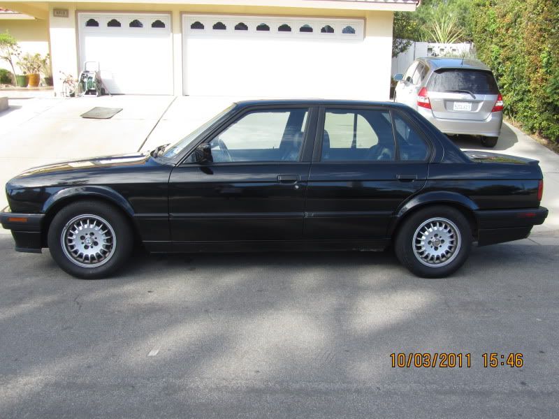

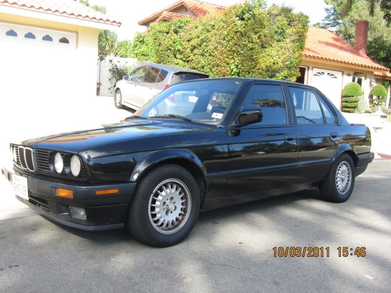

                Thanks for the input guys. Heres how it sits

                  I have the same exact setup (same exact color/apperance also). Mine rides very smooth over the crap roads here in NY.

                    Not too low at all. You should see those spring on a vert. Now that's low.

                              Stop. I highly, highly doubt you are on the bumpstops. Something was not installed correctly. There is no knocking noise when you hit the bumpstops unless it is very abrupt. From the picture I would say you are no where close to the bumpstops. I'm betting something isn't properly assembled if you are hearing a knocking noise.
