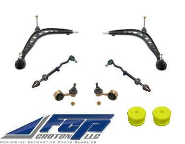

    I've got this 7 piece front suspension set from groton and strut inserts and front strut mounts as well as top hats. Is there anything else I'll need for the front suspension refresh ? 1987 325e sedan.
    Also, are most doing engine and transmission mounts at the same time ?
