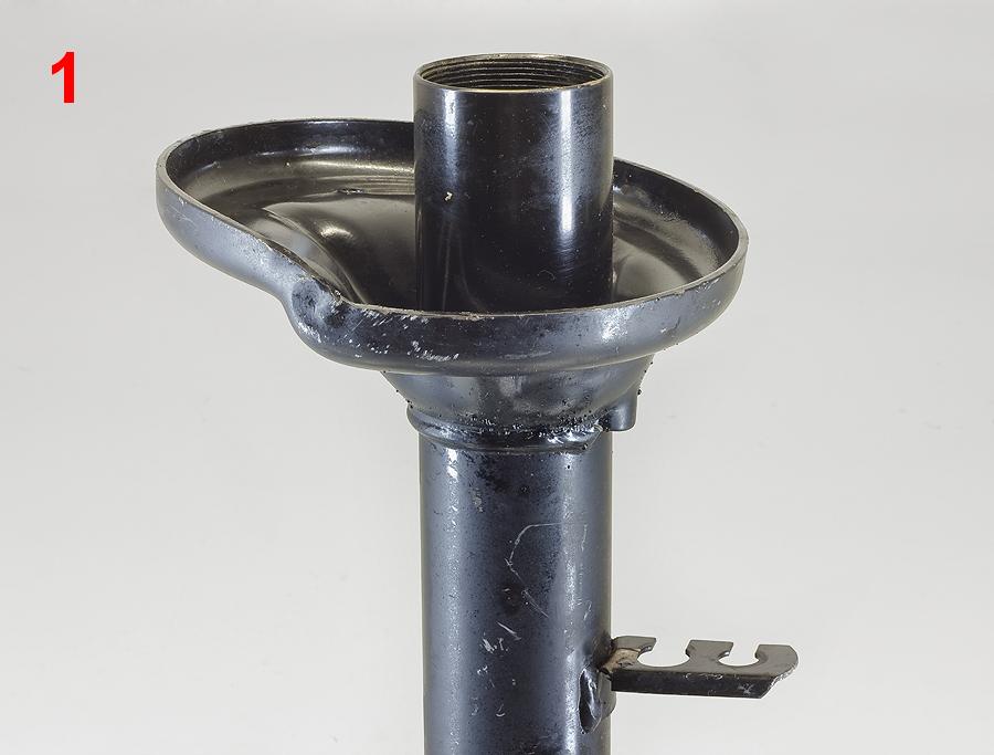

          ...also make sure you don't have a lower spring perch that is collapsing.

              The perch...
              The big "disk" your spring sits on...
              I've seen them collapse especially if they are rusted.
