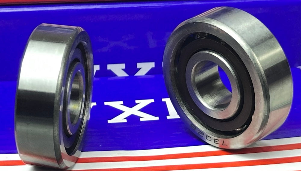

            Anyone know what the factory one is rated?
            6302-2RS Sealed Ball Bearing, the 6302-2RS inner diameter is 15mm, 6302-2RS outer diameter is 42mm and the 6302-2RS width is 13mm, 6302-2RS Bearing is made of Chrome Steel, 6302-2RS bearing has 2 Rubber Seals to protect the bearing from dust or any possible contamination, 6302-2RS bearing is pre-lubricated with grease.
            Item: 6302-2RS Ball Bearing
            Type: Deep Groove Ball Bearing
            Material: Chrome Steel
            Closures: Rubber Seals
            Lubrication: Self Lubricated (Grease)
            Dimensions: 15mm x 42mm x 13mm/Metric
            ID (inner diameter)/Bore: 15mm
            OD (outer diameter): 42mm
            Width/Height/thickness: 13mm
            Size: 15 x 42 x 13 mm
            Dynamic load rating Cr: 11,400 N (Axial or Radial?)
            Static load rating Cor: 5,400 N
            Limiting Speed:
            Grease Lubrication: 13,000 RPM
            These are axial and radial load rated.
            Buy 2-Pack Angular Contact Bearings 7302B 15x42x13mm - Order today from VXB.com for top-quality bearings & smooth delivery
            Set of 2 Single Row Angular Contact Spindle Ball Bearings 7302B, this is a popular size that could be used in many applications that needs Cobined loads (Axial and Radial), Axial loads can be taken on one direction only, bearings are made of Chrome Steel.

                    I am guessing these bearings
                    Item: 7302B Ball Bearings
                    Type: Single Row Angular Contact Ball Bearings(Spindle Ball Bearings)
                    inner diameter: 15mm
                    outer diameter: 42mm
                    Width: 13mm
                    Quantity: Two Bearings
                    Dynamic load rating Cr: 12,800 N
                    Static load rating Cor: 6,750 N
                    Limiting Speed:
                    Grease Lubrication: 14,000 RPM
