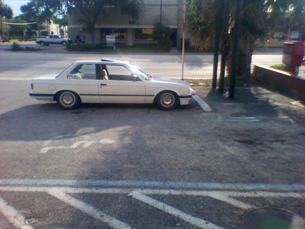

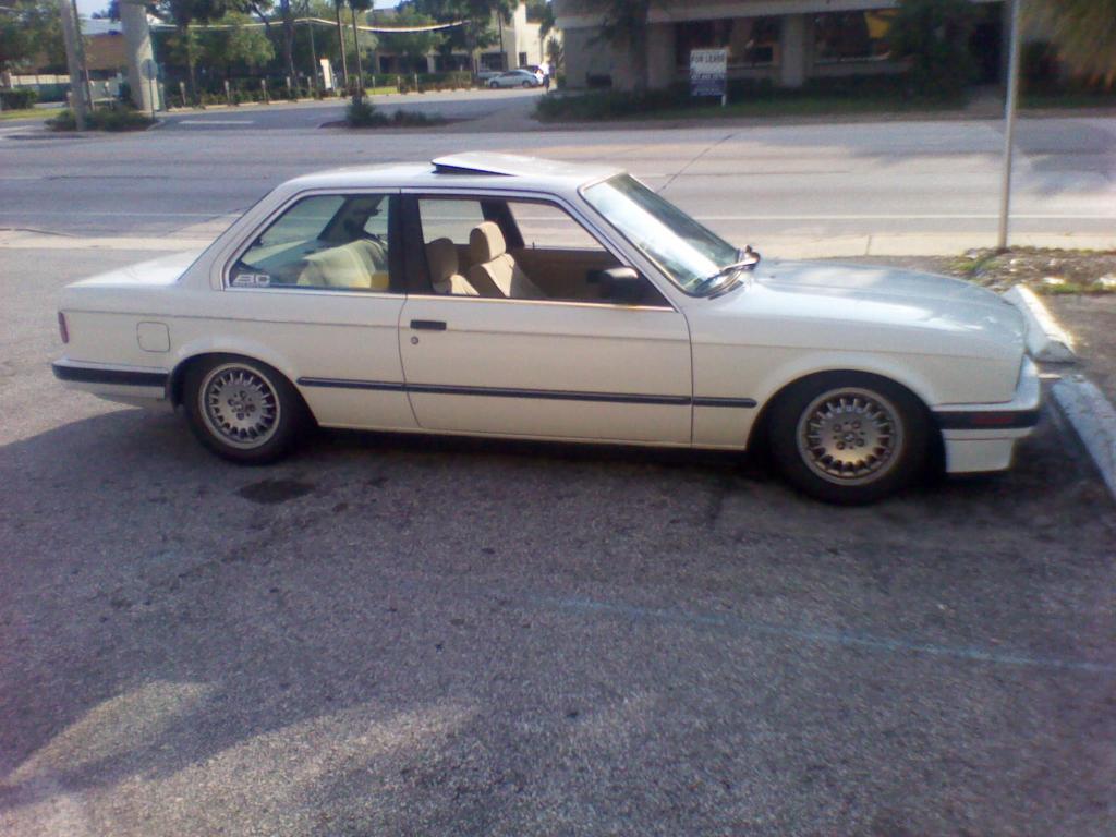

            I am really good friends with all the guys at BC. Take out the adjuster and all the rubber pieces if you want it to go as low as possible. I run a 120mm spring in the back. Here is a picture after I raised it up about an inch. Car looks completely different these days but this was right when I dumped it on BCs. They have tons of springs in stock and can send you whatever you want for a small fee.
            I actually had to cut out the factory metal bump stop holders in the rear because it was so low. I put an S52 in it so I had to raise it up. Sorry for the cell phone pictures.

              That's pretty daaamn low JT. Pics with the 120mm springs?

                When I had it super slammed it was with the 120 mm springs with no adjuster and about 10mm of preload. I added the adjuster in there with only the bottom lock to raise it up to that height. I can't find any pictures of it slammed all the way down. It only stayed there for about a week and then the S52 went in. The 120mm they have are kind of a high spring rate, I think 12k so it will ride a little stiff.
