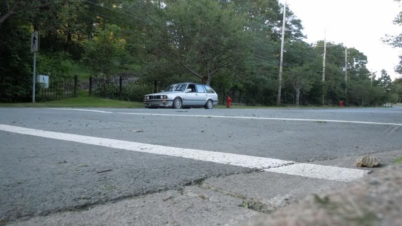

      can you post a picture of your car? i am considering H&R springs as well.
      • Roysneon
        • 4505
        This is probably the best one to see the drop. It's a 318i (M40) so it will probably drop more on a 6 cylinder car.
        Those are also oversized tires (205/60R14)
