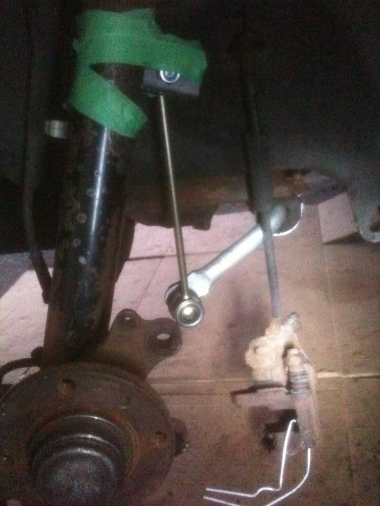

M3 style sway bar mounts, how does this look?
    Anyone see anything that looks really wrong with this?
    Besides the painters tape lol. Going to weld it soon so just wanted a second opinion.

    Why weld, that looks perfect! I'd leave the tape

      shouldnt the sway bar be horizontal with your suspension loaded?

        Drumad that's what I heard that you want it as close as possible to horizontal. Right now there is no load at all on it so it's going to become closer to horizontal i think once the car is on the ground?

          ^ correct, however you might want to put it on the ground to take some measurements so you know exactly how its going to sit. It wouldn't matter quite as much if you were using aftermarket adjustable endlinks.

            So here. I think this will explain it better. This is an animated Gif (may take a second to load) - One picture is at a height of tucking tire. The second is full drop. The issue I'm seeing is the clearance below the link. It's the control arm to link clearance. If you weld the mount too low, any lower then the stock m3 link, as the suspension drops, it will bind up - or am I not seeing things right?
            Of course the reason I wanted to weld it lower is to get the sway bar horizontal, so that it's most effective. I got that idea from Luke. I really need to stop listening to that guy. ;)

              I've always found adjustable links rough and noisy. Guess I'll go higher to be safe?

                Yea, you can't weld it too low or it will bind.

                    Ya i guess so, the ones I had also were toast after a year, were all seized. If I weld them and it doesn't work out with my positioning I'll pick up a set of adjustables.
