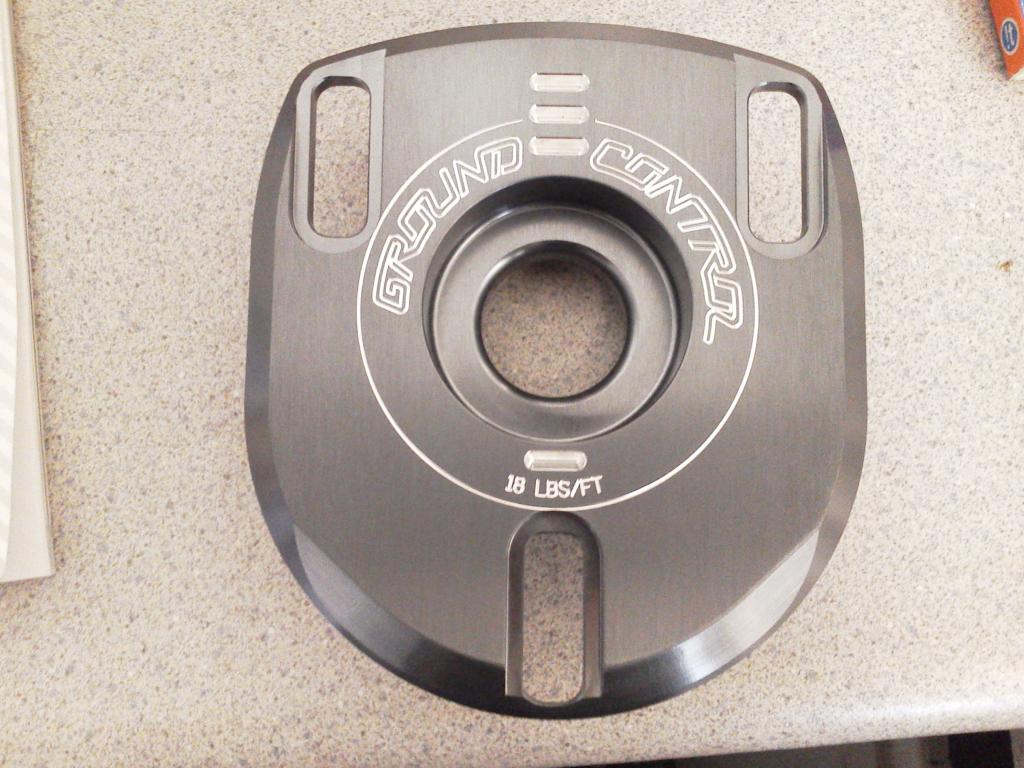

    I curently have vorshlag plates and like them. I am considering the ground control units(yer first pic). I am not sure though as its a needless upgrade. The GC plates look as though one can get more caster out of them.
    SO you are doing this to fix weird tire wear?

      I have seen the vorshlag plates and they look very similar to the GC. Why the switch?

        Our race plates are not compatible with stock style springs.
        Our touring plates will accept stock, and 2.5" springs. They are also engineered with POSITIVE camber ability built in, so you can get back to stock camber numbers on lowered platforms.

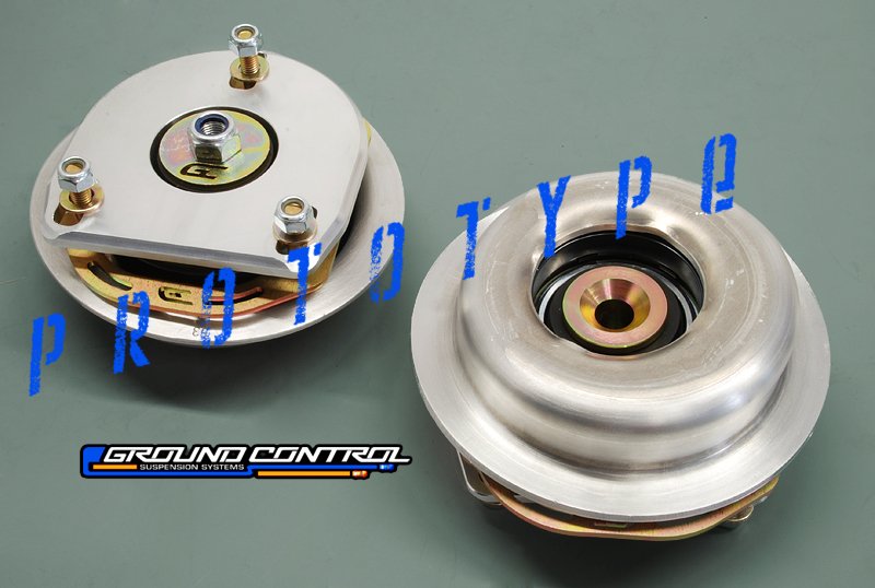

                  I have yet to come up with a visual representation of the touring setup....Correction? Is this it?
                  3mm I can prolly live with...after the $300 shock of plates! Any body have them used?;)

                    Haha, those are the actual plates I have in my 'vert minus the stock perches. Still goin strong 2 years later.
                    The Touring plates are supplied with your choice of perches, either stock or 2.5".
                    Here's a newer look. The newest batch has a circle engraved around the logo so they can be easily referenced to the stock position.
                    Crappy cell phone pic...
