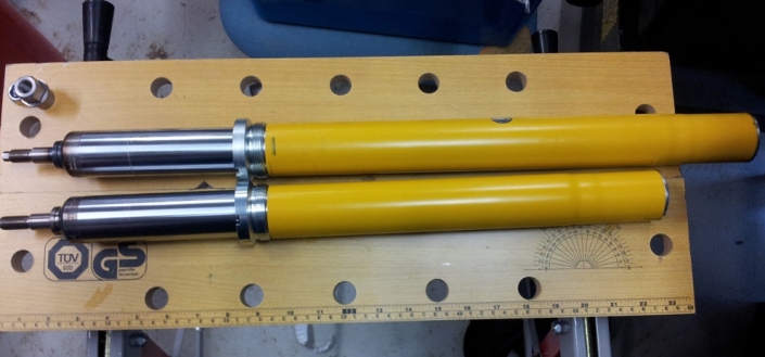

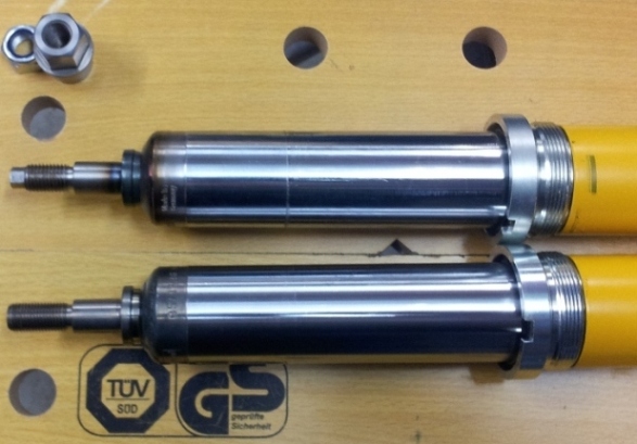

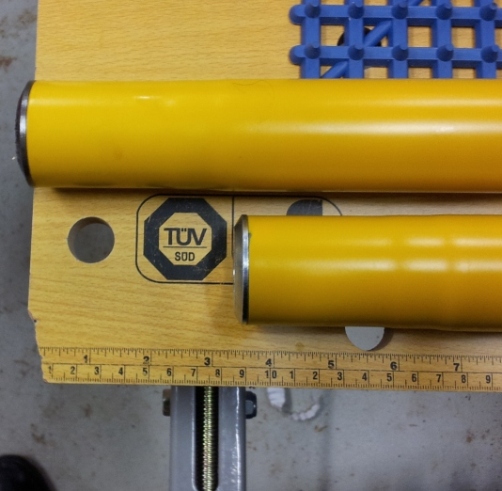

            I have both B6 iX and B8 non-iX bilsteins. The iX inserts are exactly the same as the non-iX inserts except they are 85mm short in the body. Basically everything above the threaded retaining nut is the same (except the thread pitch as you can see in the pics). Valving and bumps stops may be different
            The iX Billies are 34-002513 which supercedes P36-0251. I purchased them from eShocks.com, but Turner Motorsport has cheaper postage.
            I have had the B8 shock dynoed. I'd like to get the iX dynoed, but I am not sure if I can get it done. Certainly not in a hurry.
            *edit* premature posting and edits to the text above made. oops
            pics added.
