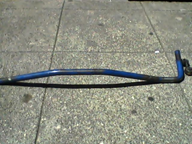

    I'm looking into buying a 26mm front sway bar. The guy who's selling it to me doesn't know the milage or the brand of the sway bar, so if anyone has an idea of what brand it is please let me know.
    Also it looks like it has a little wear on it but I think it look pretty good for what it's worth. He selling it to me for $100.
    He says I have to buy new bushing and stronger links for it. I found 26mm bushings on amazon for about $12, but I still need to get stronger links so that it doesn't tear through my car when I taking a corner hard.
    What brand of type of links would you guys recommend for this sway bar?
    Also, he has an eibach sway bar set for $200 which includes the rear and the front sway bar. The rear is 22mm, but he doesn't know the size of the front sway bar.
    Let me know what you guys think. Any advice would help thanks.

          Is that bar hollow?

            yeah.

                          That sway bar is a 25mm, not 26. The paint is what adds the extra mm. It's an Ireland Engineering bar.
                          And as for your springs, get H&R race or IE3's. Eibach pro kit is WAY too soft.
