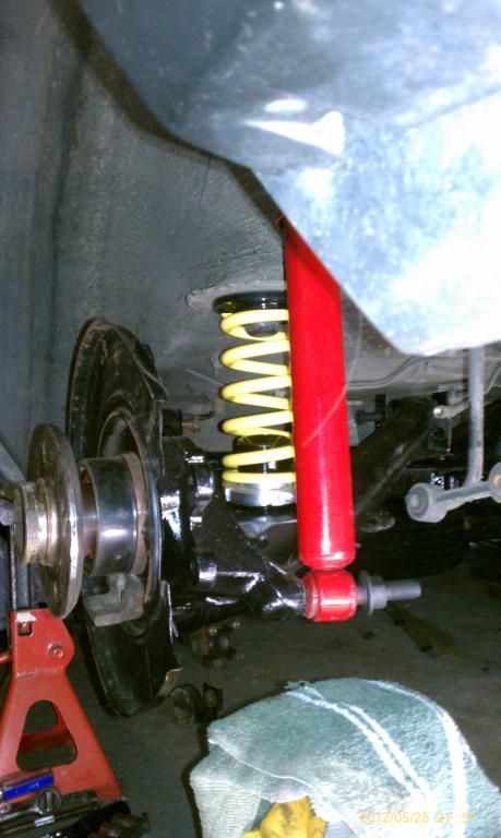

      Here is a picture of the assembly on the car. Everything looks okay?

        Yeah with our stick axles and v8s we worry about things like getting all the PBR and grits out of our mullets. Haha. You might try PMing Dewey to see how he did his setup? I'll be in the same boat as you when I fire off the trans am in a few weeks. I pulled the trigger on weight jacks as well.
