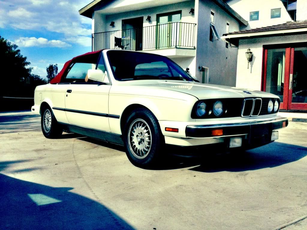

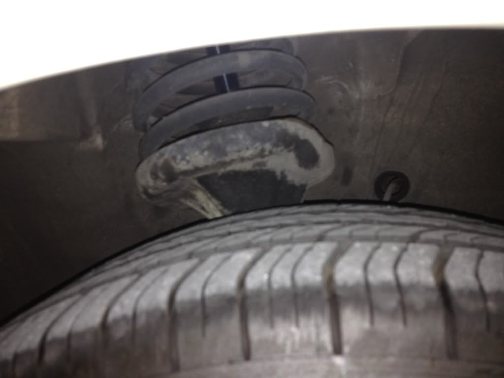

Ride Quality:
The car handles much better and is much more responsive. I must note that I also installed condor speed shop M3 offset CAB's concurrently so these probably have an impact on my review. The car feels a lot more stable at speeds. The ride isn't "too soft" at all. I actually enjoy the ride, it's not stiff but the best way I could describe it would be that it is firm

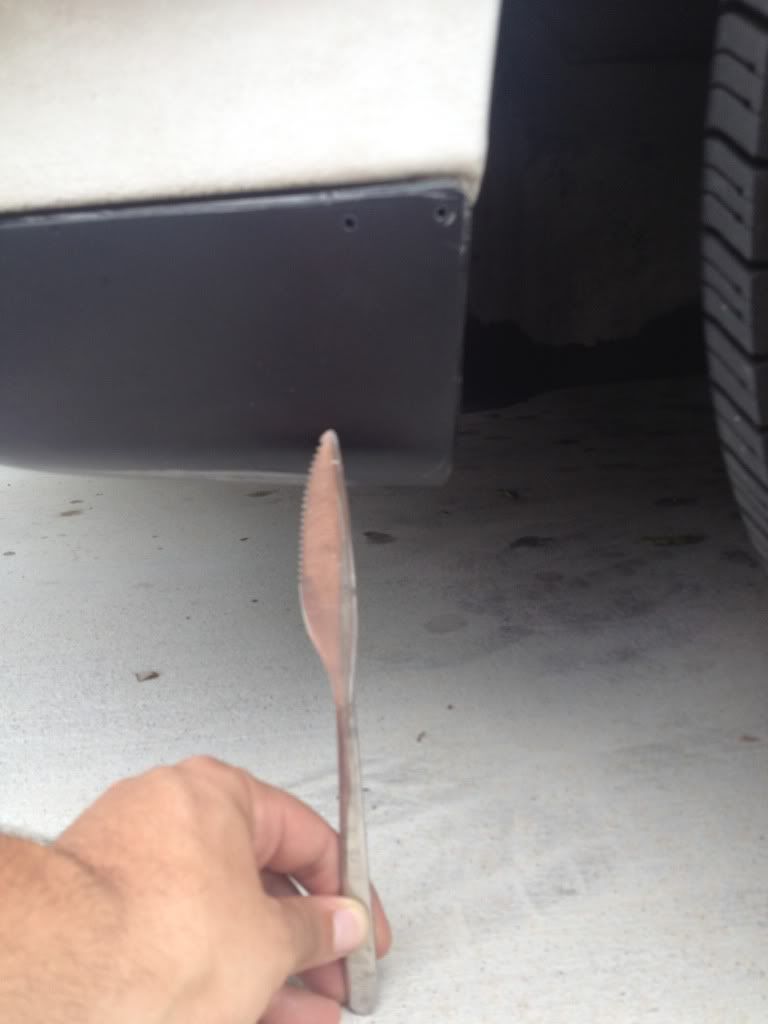

I haven't bottomed out on anything yet, and you don't need to do a racecar profile when entering a driveway with a steep incline. I wouldn't recommend going head on, but you shouldn't have any problems.
The car is much more connected with the road. I can feel the imperfections in the road, and road feedback has increased significantly. Steering is also more crisp and accurate.

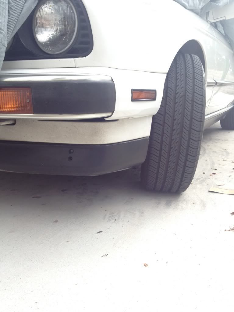

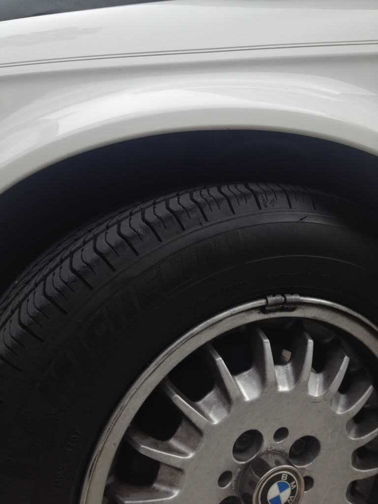

Ride Height:
The car looks more aggressive now. I'm sure once my wheels get in, it will look even better. I can fit about 2 fingers in the front wheel well and about 1.5 fingers in the back.
If anything, I actually wish it was a bit lower, but we'll see how it looks with 16" wheels that should be on within a week.

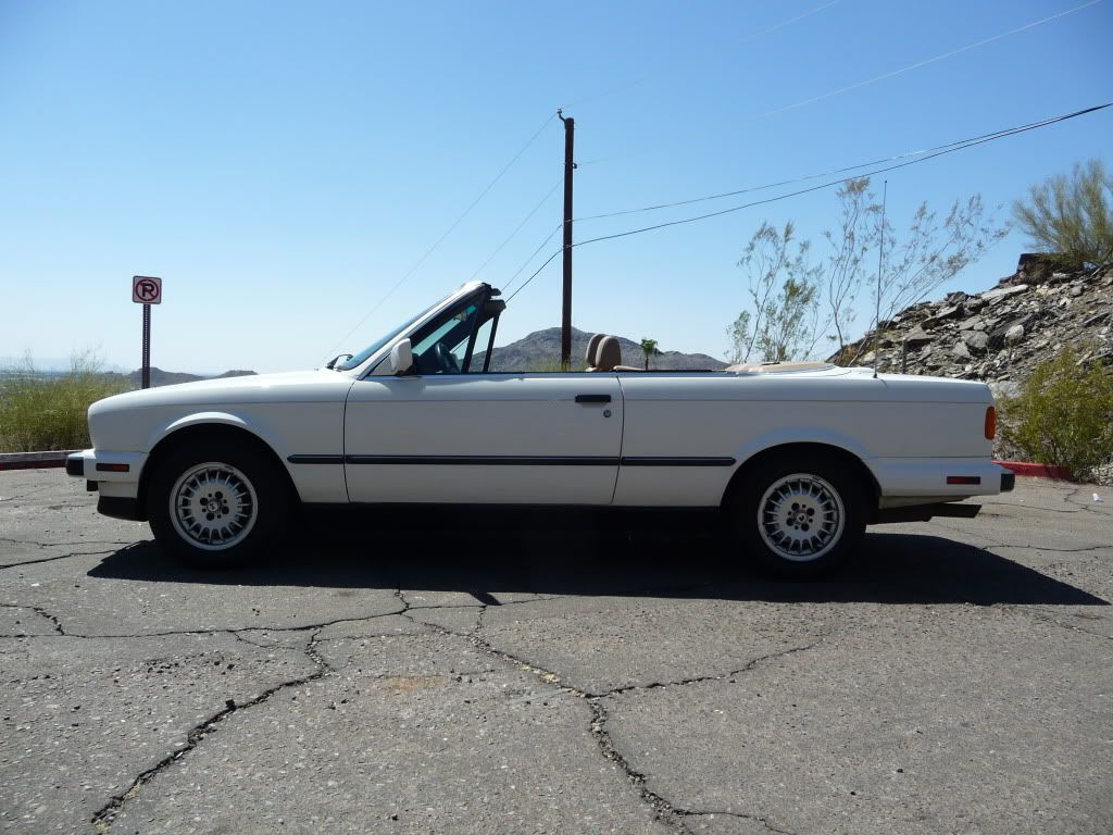

Before and After pics:
Before:
After:
