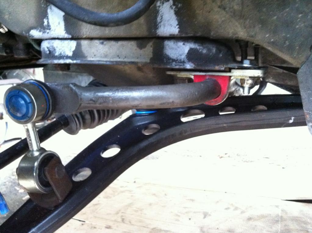

              I just got the ireland engineering sway bar mounts to upgrade to the cabrio sway bar(21mm vs 19mm). EVERYONE should buy these. One of my stock mounts had actually just fallen apart because the tab failed. Click image for larger version
              This kit is great because it utilizes the subframe bolt and the stock mounting point as well as urethane bushings.
